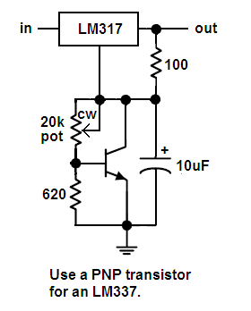

Got the parts and i'm putting them together now. I notice that one of the regulators, the LM 337 -v one, looks very different to the 317. Rapid says that they are both NSC devices, but they look very dissimilar. I checked the unusual looking 337, and the pinout is correct. It says Fm E28 across the top if that means anything to anyone :? . I'm just wondering if its going to work in harmony with the other (ie, when one is set to +9v, with the other produce exactly -9v?). Any ideas?

Ok, i've fixed it all to stripboard, and i've tried testing it with what is probably a very innapropriate supply, +8.4/-4.7v, taken from some apparently quite drained batteries. Either way, i'm not convinced this is working as it should. I can't see any errors on the board but here's the readings i'm getting from it:
With the control set clockwise:
+1.52/-1.50v
With the control set anticlockwise:
+1.94/-1.92v
Thats wierd for a start as it should be higher with the control set clockwise. I've triple checked that its connected as specified. But other than that, these seem to be very small voltage readings, even for that supply. The voltages at the bases of the transistors go from 0.33-0.68v, also very small. No part is getting hot, but there is no load connected. I've used the BC549 and BC559's as specified, although mine are in fact BC549C and BC559C if that matters, I thought that the C meant it was a higher voltage rating? At the moment, i'm suspicious of those, although this may be normal operation for such a low voltage/imbalanced supply :?
Any help much appreciated :)
Hi Dr. EM,
Your batteries are dead and can't supply the 12.5mA required by the 100 ohm resistors. The minimum input voltages for the ICs are about 3.3V plus 0.6 for the transistors. So with a 3.9V input the circuit's output voltage can't be more than about 1.9V which is its minimum output voltage with any higher input voltage. Try each section separately with wall-wart DC supply that has enough volts to alow the circuit to work.
If the pots operate backwards with a higher input voltage then they are wired wrong. When the slider shorts the base to the emitter of a transistor then the circuit's output voltage should be at its highest, which is about 2V less than its input voltage. :lol:

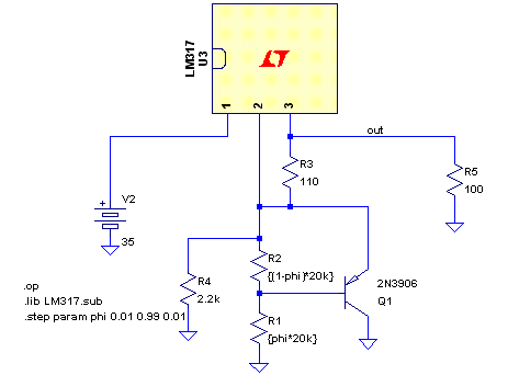

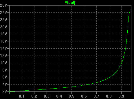

I don't think you're gonna like the voltage vs pot position in the version with the 20k pots and transistors. With 2k pots, you get a linear rotation angle-to-voltage relationship. With the transistors, the curve looks exponential, with most of the change happening near the clockwise end of the rotation (clockwise --> higher voltage). I ran a sim that shows this (see below).
Phi (horizontal axis) is rotation angle as a decimal fraction of full scale.

Hi Ron,
You and your sim are correct, the project is grossly flawed. :lol: :(
I didn't yet but will look on the author's forum to see any discussion about it.
I figure that the circuit will work the same if a common-emitter NPN transistor was used in the LM317 circuit, and visa-versa.
When the pot is halfway, the transistor will have 1.45V across it and the output voltage from the regulator will be that 1.45V plus the 1.25V reference which equals only 2.7V.

Ok, i'll definately try this with a 12v wall wart if I can dig it out :D
Ron H, I completely believe you, I had an idea this is how it would work. To be honest, I don't think the version with the transistors has ever been fully tested, or at all. If it does turn out very much like that, then I may have to try and get 2 seperate 2k/2.5k pots, and adjust both voltages seperately.
Or, what do you think to using a 1k with a 470ohm at each end or an arrangement like that? I'm assuming that would make it a smaller range of voltages, but i'm not likely to need below +/-9v or above +/-18v. Would that still be linear? If it would, i'll probably grab a 1k dual gang from Maplin and use it like that, removing the transistor and 2.2k as required.
Wierd post at the same time there :lol:
I tried this with the wall wart, which actually reads 17vdc.
With the board I get from 1.90v to 2.13v, with the 2.13v being when the control is set more or less central :? past central, it drops back to 1.98 or so.
Totally useless if nothing else :lol:
