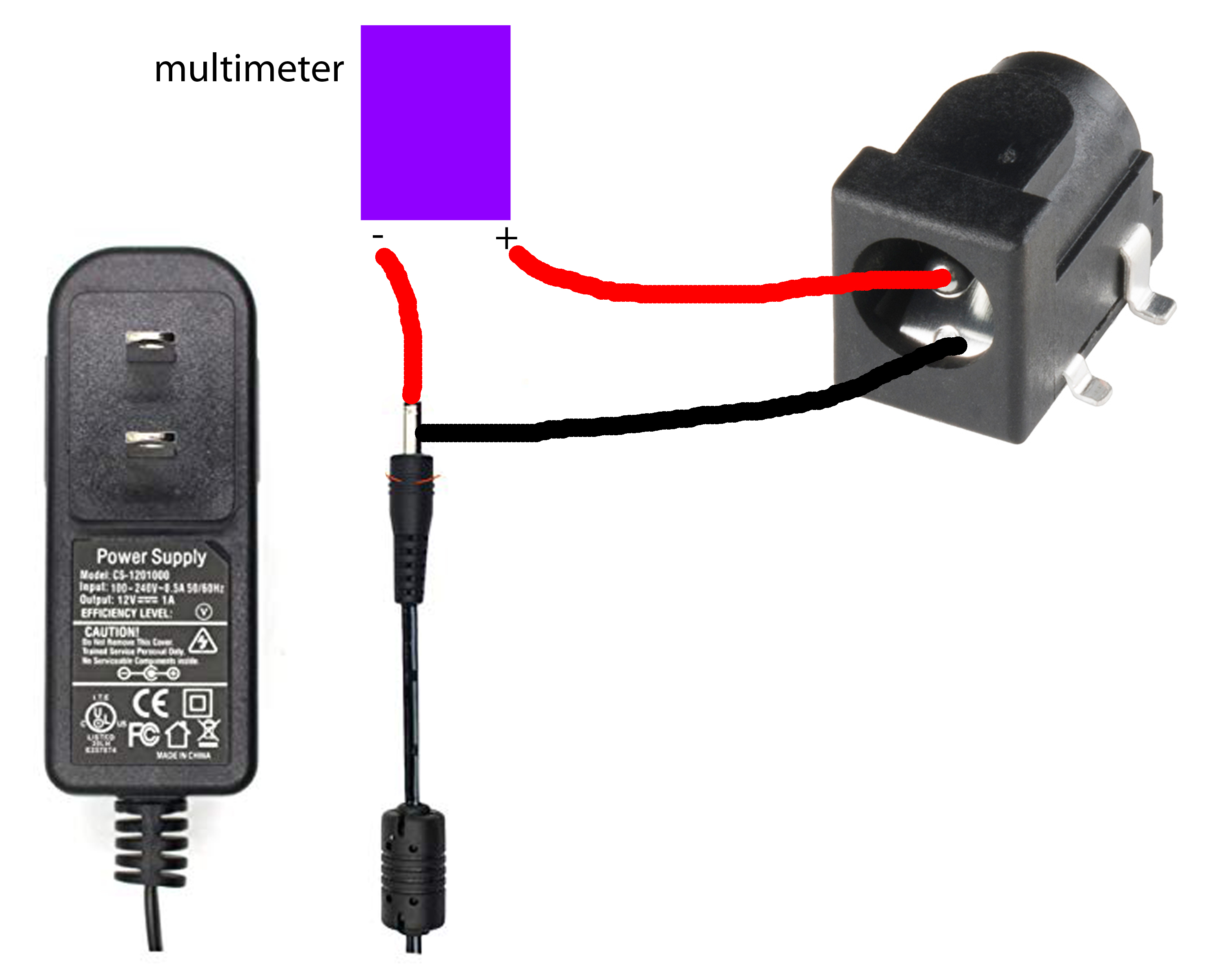

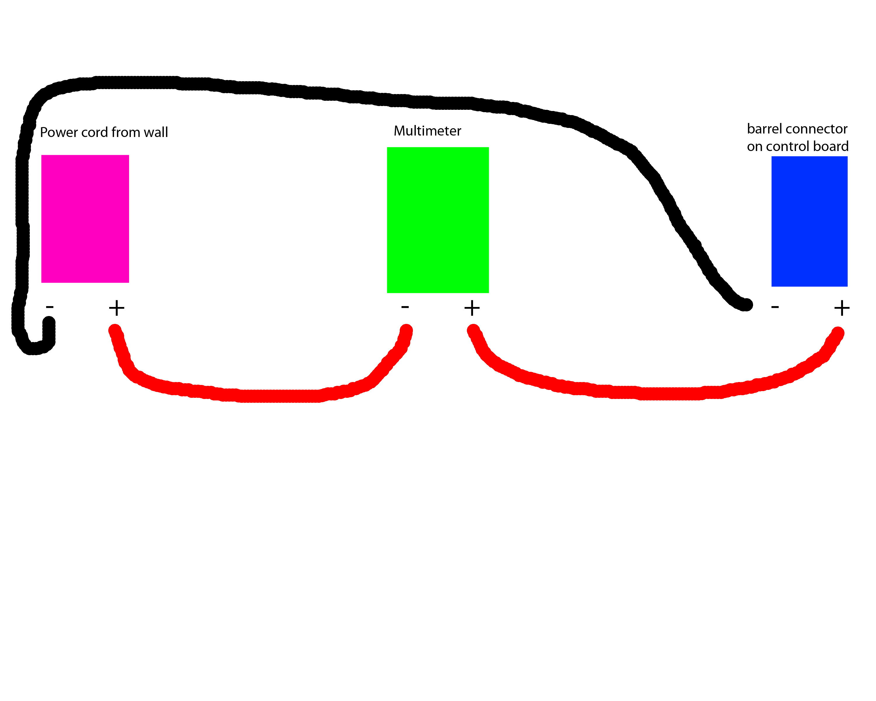

Thank you! Ok, so from what i found, I want to make sure I understand this before doing this, I have to hook everything up and splice my power supply from the wall to the control board of the monitor. Then supply power (from the wall) to my multimeter (set to mA) and then into my control board? If this is correct, I may have to get creative because I only have 1 power supply cord for this board. So I'll have to buy another and splice it, I suppose.
If my explanation above wasn't detailed enough is this clearer of what I am thinking?
Take power cable, cut wire, take positive feed and attach positive terminal of multimeter to 1 part and the negative to the other part of the positive lead. Set multimeter to mA. Plug in and measure?
*Thought* Since it is a barrel connector, instead of cutting the wire, would I be able to (in theory) just make 2 leads, one coming from the ground of the male end (the outside) to the pressure tab (ground) of the female barrel connector on the board and another lead from the inside of the male barrel connector to the probe of the female end on the board? Or is that just too dangerous?

Is there anything that I'm incorrect on?
So on that, cuz I will definitely go that route. Do they make those in 2.35mm? Cuz that's what my connectors are. Or do they only come in 2.1mm and if so, what alternative can I go with?
