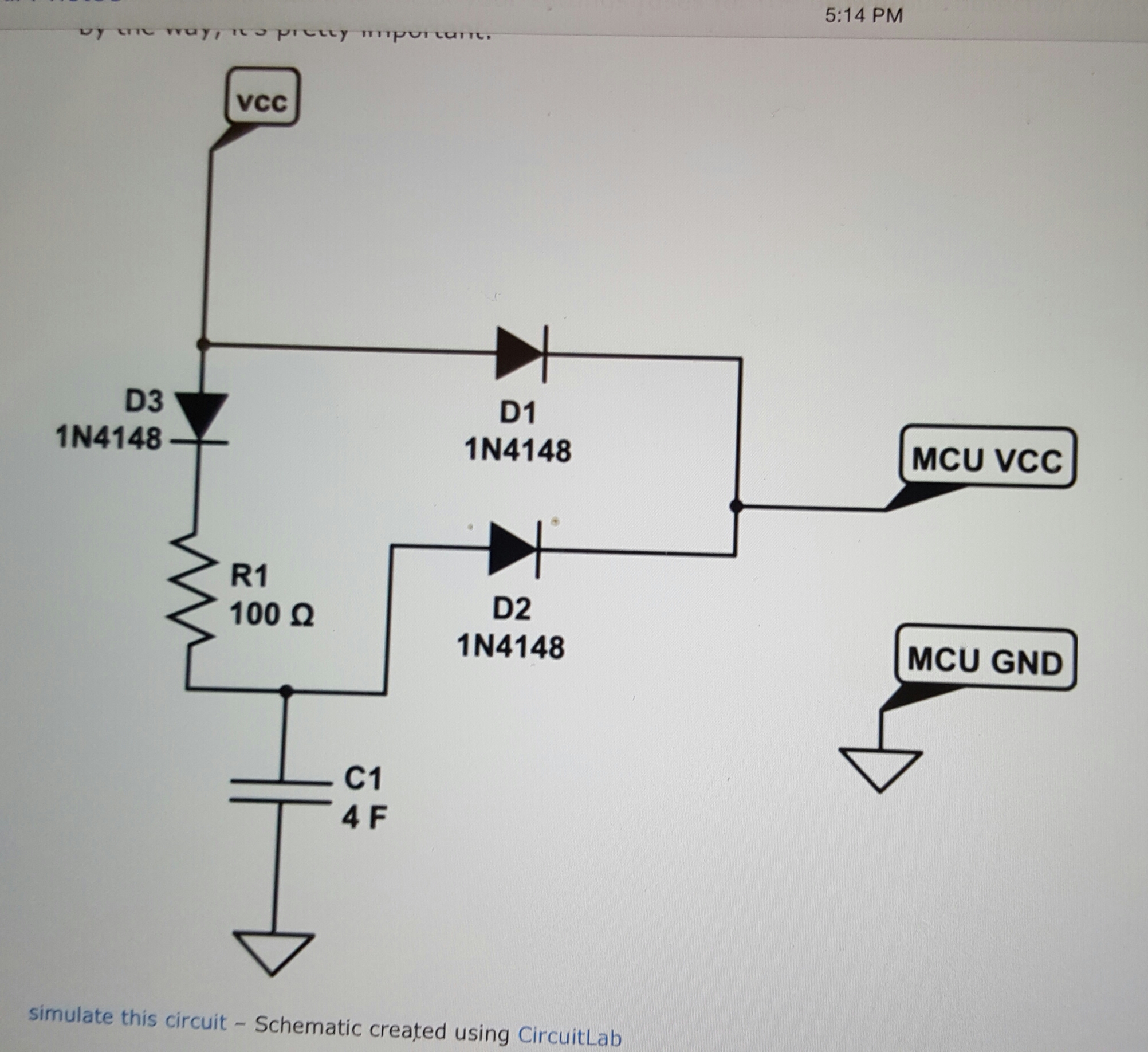

I have a data logger circuit designed to monitor 8 test signals. One of the signals it monitors is the "reset" signal, just after which the unit under test starts a reset process by killing the power supplying my data logger. I'm going to add a supercap to keep the Microcontroller, EEPROM and I2C port expander active long enough to write the status of the monitored lines to EEPROM when the "reset" occurred. After that point, the micro can enter a low power sleep state or even halt program execution until power is restored.
My concern is the unknown state of the supercap when the monitored system is restored to operation and power is restored to my circuit. If the supercap is flat, my PIC18F will get a fresh start and program execution will resume. No problem. If the supercap isn't flat by the time the system is restarted, my PIC won't be reset and it will be stuck in a sleep state.
My first thought is a voltage supervisor chip powered from Vcc, not the supercap. But I don't want this chip is assert a reset as the voltage drops when cut. This is when my PIC needs to record the reset/power fail event.
One solution would be a one-shot triggered when Vcc comes up which would assert a reset to get my PIC going. A 555 circuit could do this. Any other simple approaches come to mind?

The DS3231 power fail voltage triggers when its VCC = 2.45V-2.7V. I assume that VCC is not the "supercap" VDD running the pic?
It would help to know which pic you're using, and how you're arranging the VCC connections w.r.t. what's powering what.
What about just enabling the pic brown-out reset so that it stops running when the supercap voltage is too low?
The picture shows essentially what I'm doing. Vcc powers the RTC (which has its once backup coin cell). The micro, EEPROM, and MCP23017 are powered by MCU Vcc. They literally only need to be powered for seconds to record the sequence of events leading up to the loss of power and the state of the 8 monitored lines until the point power fails. All 3 diodes are Shotkeys.
When the micro, a PIC18F26K22, has finished the above, it can go into a sleep mode. When power fails on this system, I don't know if it's seconds, minutes or even longer before it's restarted. if the supercap is dead (enough), the 18F26k22 will get a clean start when power is restored. On the other hand, if the voltage is holding on the supercap, the 18F26k22 will be stuck in sleep mode. All of Port B is used for data acquisition so I can't use any of those pins to trigger an interrupt condition.
Barring any great ideas, I'm going to use a watchdog timer chip powered by Vcc. If the micro is lost in never never land when Vcc comes back and doesn't toggle the WDT chip, the WDT will reset the 18F26k22 and I'll be back in business.
The watchdog idea would be my preferred one.
It is simple and low cost, and many companies manufacture them, so you should be able to pick up one that fits your needs.
