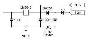

Hi all, this is the part i find hard it is constructing the hard ware for my project, i am trying to do it in a modulay fashion so that it makes it easier to understand, my project will require the usual 5v for the microcontroler, plus a 3.3 and a 12 for other devices i intend to use. Could someone have a look over this diagram and see if i have it right, or if there is a better way then please feel free to post it. :D (Ive moved this post because i posted it in Microcontrollers by mistake) Ooooops Sorry:

The 3.3volt supply looks very odd.
Why is there an LED in series with the supply?, you will drop ~2.2volts across that thing.
100 ohm in series with the battery, what charging current does that give from the 3.3v supply?

I mean, the lithium battery don't like the charging. Need a serial diode...

Well that is just what i thought which is why i posted. but take a look at this link and tell me what you think:

I think you will have a hard time finding the LM3840 regulator.
The LM3940 on the other hand, would burn up when you fed 15V to its input as it is only rated to 7.5V max.

Connect LM3940 input to voltage less than 7.5V, perhaps to the output of 78L05?

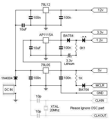

Hmmm ok eblc1388 is this better? by the way thankyou for your help.. :D

Now you have moved the 10uF away from the 1N4004 and the two(78L05 and 78L12) regulators input has no large value capacitor. You should consider adding a 10-100 uF capacitor at the input of the two regulators.
The diode type 1N4148 at the MCLR pin is not recommended. Microchip datasheet stated that it should be a Schottky type, like the BAT54.

I would suggest you keep the two 100nF caps. You don't need to add two 10uF capacitors. One is sufficient.

You should also try to find other choices for the LM3940 as it is a large size TO-220 type regulator rated at 1Amp. I think there are alternatives of a smaller size.

Ok found a regulator that may fit the bill and it is in a TO92. i was going to take the supply directly from the 12v boat battery and that is connected to the alternator what other smoothing whould you suggest?.

Now there is another minor problem. The 78L12 can only provide you with a 12V output with at least 15V input. So if the engine is not running, you might expect to see less than 12V output if the battery voltage is only 13.6V or less. Make sure the circuit getting this voltage does not mind.
On the supply filtering issue, the aim is to remove the voltage spikes on the power lines using filters. These can be R-C or L-C types and follows by a special transience absorber called "Transorb" which is just a posh name for a zener like diode. Never used them but learn that from the forum and have absolutely no idea where in UK one can get that.

Well the 12v regulator is more to put a cap on the voltage than anything else the device that will use this line has a voltage window of 9-15v so im hoping that any drop in voltage will be well within limits. As for the zener thankyou for the clue which i will investigate.. may i take this moment to thankyou for your time eblc1388, and not forgetting the input from others who have participated in this thread thankyou all...You never know someone other than me may find this thread usefull.. :D

Note he said, 78L12, not 7812. L is a designator for an LDO. Dropout is 1.7v for a 78L12.
You still have the LED in series with the 1.2v output. This is probably an error.
The diode going to MCLR is rarely useful and can cause some serious problems. The resistor is still necessary.
Why the 1N4004 on DCin?
We could help you better if you could describe exactly what you need to do. What are your loads? What are you powering it with?

"L" certainly does not mean low dropout. It stands for low output current in the 78/79 series.
The 1.7V you have quoted is only the typical value at 40mA output and from studying the datasheet graph the actual voltage differential at 100mA could be well over 2V. It can't be a low dropout regulator with such voltage differential.
From the datasheet, the worst case value of input voltage to maintain regulation is still 14.5V or more.

No, it is not. The purpose of the LED is to drop the 3.3V into 1.2V using the voltage drop across the LED. Read the link the OP had posted on the original circuit design.

Not only is it useful, it is a requirement to prevent 13V from going to the other part of the circuit or the PIC itself when one do HV in circuit programming. Leaving out the diode risk damaging the rest of the circuit unless one never use HV programming and stick only to LVP.
When you said it can cause series problems, can you share what problems it can cause as adding the diode is what is stated in Microchip datasheet.
