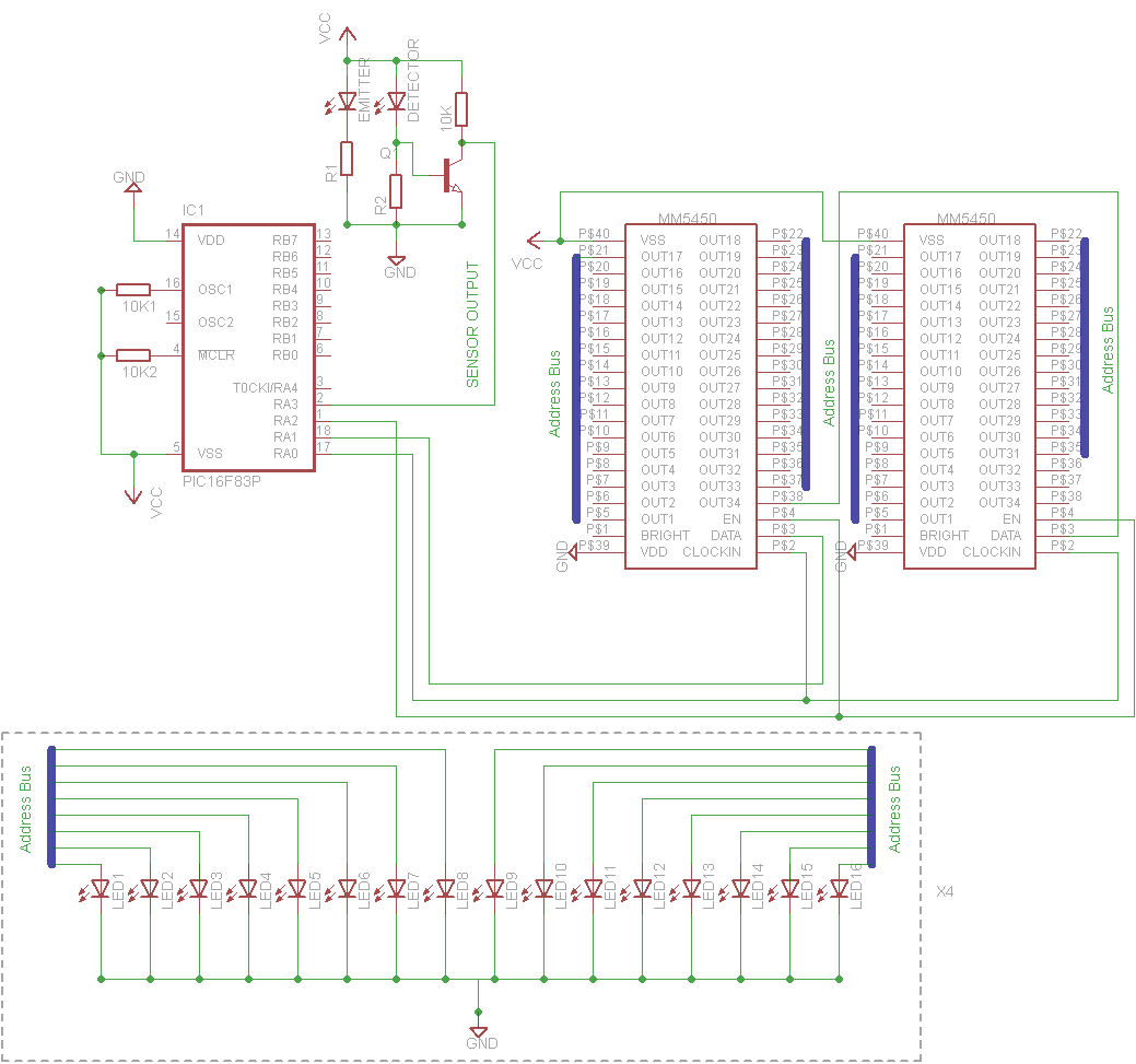

Ok, here's my first attempt at drawing a schematic.
I included 2 MM5450's (SM parts), a PIC 16F88 (I think), 64 0603 SM LED's, and a simple IR emitter/detector circuit to measure the spin rate of the hard drive.
Note:
  1. This is my first attempt at a schematic and I am sure I violated good practice everywhere
  2. The "Address Buses" were just added to keep from cluttering the diagram, each output goes to a separate LED for a total of 64 outputs to 64 LEDs
  3. I only showed 16 of the 64 LEDs
  4. The IR emitter/detector circut shows two LEDs, but one of them is suppose to be a detector.
  5. I don't have any resistors for the LEDs because I plan on using the MM5450's current control, when i figure it out.
  6. Finally, I have no idea why I have the 3 10K resistors, I just did this because I've seen it done in similar circuits.
What PIC is that? It says 16F83P. There's no such thing. :p
You have the PIC's ground (VSS) connected to VCC, which would be 5V, and you have the PIC's VDD connected to a ground symbol. :D OH! I see you did the same thing on the 5450 connections. You'll smoke chips if you wire them that way. :p VSS=Ground. VDD=Power.
Ground symbols should always point down, and power symbols (VCC) should always point up. Some people like to draw a ground rail across the bottom and a power rail across the top and connect everything to them, but that's optional.
I sure wouldn't pull up the OSC1 pin like that. Remove that resistor. MCLR should be pulled up as you've done, though I'd use a 22K or 33K resistor instead of the 10K. The 10K is ok though. It just wastes a little more power.
One more fairly big mistake is that you have all your LEDs backwards. The MM5450/5451 chips' outputs are designed to sink current. That means that when they switch on, they switch to ground. They're not able to source current. So you should connect the LED cathodes to the chip and supply power to the anodes.
That's all I can see with a quick look though. Not too bad for a start.
You have the PIC's ground (VSS) connected to VCC, which would be 5V, and you have the PIC's VDD connected to a ground symbol. OH! I see you did the same thing on the 5450 connections. You'll smoke chips if you wire them that way. VSS=Ground. VDD=Power.

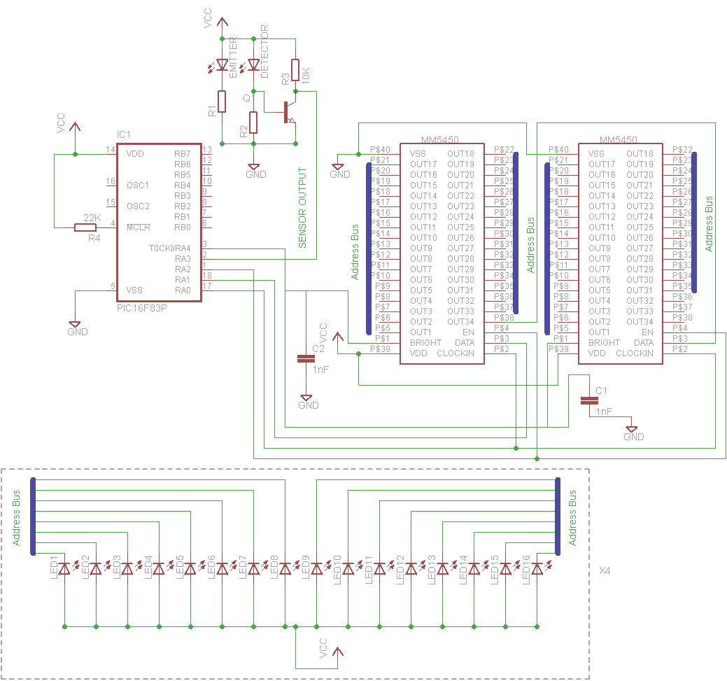

Wow, yeah, I'm really glad I don't have the parts yet, haha!
I fixed those problems and added a few wires and capacitors for brightness control, but not sure if it's configured properly.
I'll also go ahead and add some wires for IC programming since I have free pins.
I included 2 MM5450's (SM parts), a PIC 16F88 (I think), 64 0603 SM LED's, and a simple IR emitter/detector circuit to measure the spin rate of the hard drive.View attachment 24636
you need another pin. The last bit latches so you can not run these in series like that.
Split the enable pins to direct the serial data stream to one or the other. If you do not want to use another pin you can put an inverter between them.
