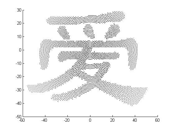

Anyways, I haven't made any progress on the hardware aspect of this project, but I have made some major headway into the software part.
The idea is to plot 2-d Cartesian images using polar coordinates, because that's what I'll be using in my POV.
I'm using MATLAB to convert images into matrices of polar coordinates (angle and radius) that will be used in the POV hard drive. The m-file is very simple and basically takes an imput of dtheta, R, and the image file.
dtheta is just how often I want the LED's to change. So dtheta = 1 translates into 1 degree, so 360/1 = 360. Hence, my POV would have a resolution of 360 x 64 (because I have 64 LED's across).
R is the radius of course.
The image file can be pretty much any format, but jpeg is preferred. The image size also has to be less than 128 x 128 (64*2).
Anyways, here's an example of how it works:
the attached images show how it works:
Raw image w/ 64x360 grid mapped over it:
Plotted binary image using polar coordinates:
When the POV does the plotting, the coordinates will not be dots, but nearly rectangular wedges as the POV sweeps fro theta to theta + dtheta. I could probably simulate this in matlab, but I'm too lazy.:rolleyes:
