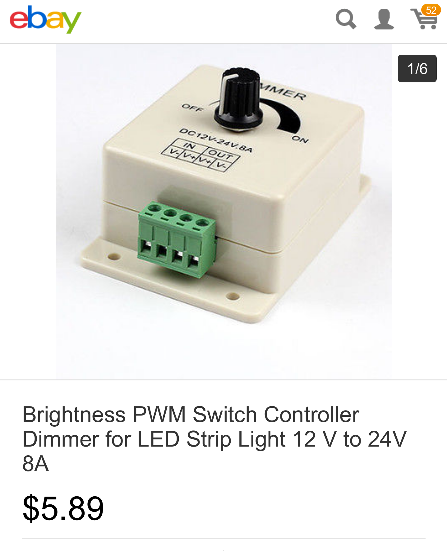

You need to use PWM (pulse width modulation) to control the brightness. Look on eBay for "LED strip controller" and you'll find many options. You need to find one that will handle the current your strip draws; there should be a spec for amps per foot to determine this, or just check the current drawn from your power supply without the pots installed.
One option is shown below. This is the simplest, and similar to what you're trying to do. A pot controls a PWM circuit to drive the LEDs. You'd need 3 of these, one for each color.

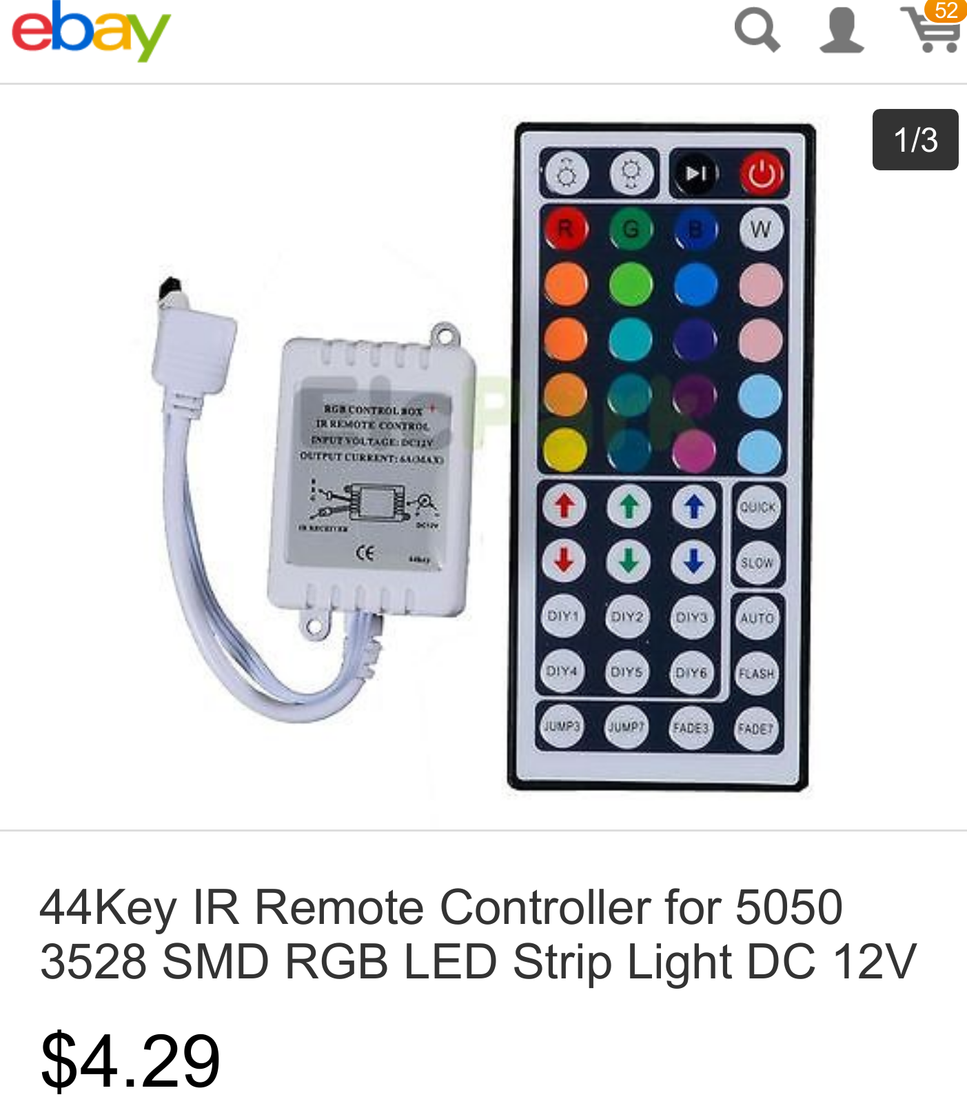

Various "electronic" controllers are available too. These have many effects, like flashing and varying the colors in different patterns. The downside of these controllers is if you just want to vary the color, all the options can make it complicated to get what you want.

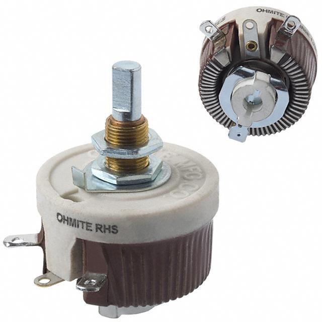

Here's a typical pot like I'm guessing you used. It's rated at half a watt.
This wirewould beast is rated at 25 watts....and it costs 50 bucks! It was a reasonable guess when you said you tried a bunch of values that they weren't rated quite this high.
A huge expensive high power pot was used as a light dimmer 100 years ago. Today we use Pulse-Width-Modulation controlling an inexpensive high power Mosfet and a cheap little low power pot.

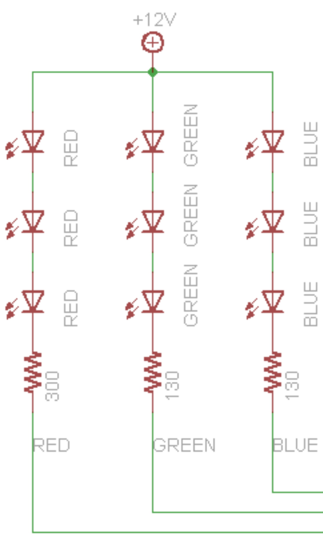

The typical RGB LED strip set for 12 volt operation has groups of 3 LEDs in series with a resistor for each color; 3 red LEDs and a resistor selected to provide the right current, 3 green and a different value resistor, and 3 blue with the appropriate resistor. The resistors are different for each color because the forward voltage of each color is different.
The forward voltage for the red LEDs is about 2.2 volts each, or 6.6 volts for the series atring of 3. The resistor is sized to drop 5.4 volts at the desired current. The forward voltage of the blue LEDs will be 3.3 volts or even higher, making the voltage drop forvthe strip nearly 10 volts.
So why is this important? If a pseudo-variable resistor is set to provide 10 equal voltage steps from the 12 volt source, as soon as the voltage is reduced below the foward voltage of the series string of 3 LEDs, they won't illuminate! FAIL.
