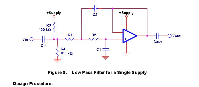

Simple rc filter is not good solution. i cannot find mcp6042 and mcp6041 could i use lm324 or mc33204 like on picture?

The inputs of an old LM324 quad or LM358 dual opamp do not work if they are within 1.5V from its positive supply voltage as shown on its datasheet. Its output does not go within 1.2V from ground.

"Simple rc filter" is a good solution.
The potentiometer itself can be (most of?) the 'R' part: the 'C' part can be as large as need be without adding too much time delay.
With a potentiometer, the time delay is close to irrelevant: dozens/hundreds of milliseconds will be undetectable.
Also, if your supply-voltage is for sure to be 5 V=volts, try LMV324. Superior in all respects and 23 cents pricier.

Texas Instruments says the LMV324 and LMV358 are obsolete. Their datasheet says their inputs do not work when they are within 1V from the positive power supply voltage.

It's the LMV324-Q1 that went obsolete: Digikey claims to have ~100K of the non-obsolete parts left. And yes, the input can't exceed 4.2 V or -.1V. Dammit.
