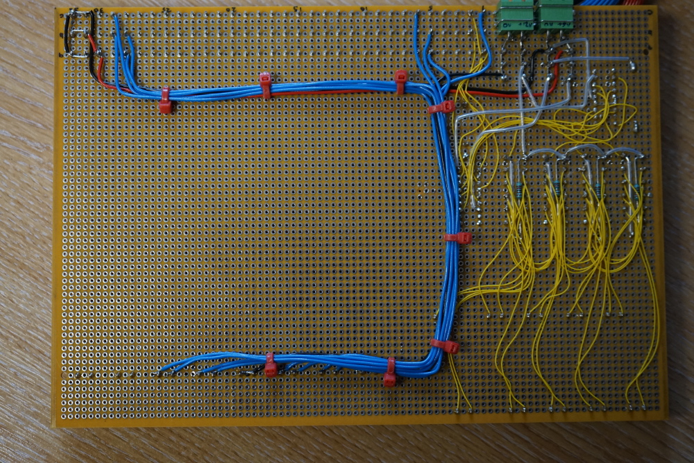

Yours looks lovely on the top, but what about the bottom?
There also seems a rather minimum of wire colours used?, presumably you wired it one wire at a time?.
These ribbon connectors take all of the tedious actions out of installing something like 32 pots. It turns the task of soldering wire ends into a plug/play process. Soldering a 25-pin connector to a board is so much easier than soldering 25 wires to a connector. Also, crimping pins on a connector is a pain in the butt.
Watch this and you'll never use another method for low current signals for pots/sensors.
A bit of thread drift coming up here...
You asked, so here it is:
Not all of those 96 wires from the DIN41612 connector are used, but I decided that it was better to just wire them all, just in case.
A later modification would be a real pain.
Yes.
I cut the wires to length in batches of 32 ( 32 red, 32 blue, 32 black), soldered them to the connector and then formed the cable harness.
I then used a multimeter to select the correct wire to connect to the Vero pin on the circuit board.
Actualy it's pretty neat - but I expected far more wires
