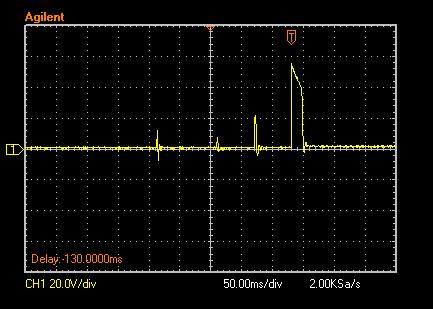

Mains transformers, DMMs, Continuity Tests and Confusion - Follow Up
Earlier Fezder asked
Does this happen with all transforrmers?
Since then, I wondered if it happens with all DMMs, and, can we display the problem on the oscilloscope?
So as a test, I connected the original cheap DMM to the mains input of the function generator to see that the effect was still there (it was), and then connected the scope across the DMM and found the waveform shown attached here as Cheap DMM.
I then connected my (expensive) Fluke 8840A bench DMM.
When the DMM was set a fast sample rate there was a fair amount of jitter on display, but the autorange set the correct range.
Slowing down the sample rate, the display was nice and steady.
Looking at the waveform Fluke 8840A we see that there are still large spikes, but the DMM just settles down and gives a steady reading.
With the Cheap DMM we see that the spikes are of both polarities as the autorange switches up and down.
With the Fluke, the spikes are all of the same polarity as the autorange switches down to the lowest range and stays there.

wow, interesting measurements :) yet another difference between cheap and expensive dmm's.....at what price were these around?
The Cheap DMM is probably not as cheap as I make it sound, it is 15 to 20 years old and probably cost £30 when I bought it new.
The Fluke was second hand when I bought it, about 3 years ago. From poor memory I think it cost something like 150Euro (I bought it in Germany).
When new it would have cost a lot more than that.
