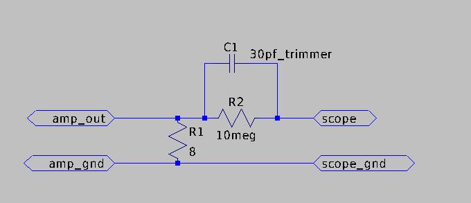

X10 circuit for 8 ohm dummy loads...
shown is a scope adaptor for an 8 ohm dummy load. the trimmer cap is adjusted for flat-topped peaks on a clipped signal. this circuit is for a 1Meg scope input impedance. the wiring from the adaptor to the scope on mine is RG-214 teflon coax but can be any coax cable.
Hi. I dont see circuit. Please post again please!!

how's that..... this board crashed a few months ago, and some pix are still missing
