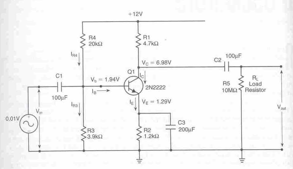

That makes sense. In this schematic, I am told that R2 provides negative feedback. How does it do that, seeing as it is not connected to the base of Q1? Also, can positive feedback be not connected directly to the base? If so, how is it done?
The emitter resistor (R2) provides a degree of feedback.
When u say that R2 provides a degree of feedback, are you saying that it doesn't provide all of the feedback? And I didn't really get my whole question answered. How does it provide negative feedback if it's not connected to the base of Q1?

Zach.. I understand your question. First, it is important to understand what it is that is being fedback. In the circuit, the current that is flowing through the R2 resistor comes from the emitter of the trans. If you consider the operating point of the transistor at a given current, this corresponds to a particular Vbe of the transistor.
Now, if you were to increase the current through R2, this would increase the voltage drop across it (ohms law) and the emitter voltage would rise as well with respect to ground. This in essence _decreases_ the Vbe drop of the trans. A Vbe that decreases, tends to _decrease_ collector (and emitter) current.
So to summarize, a current that wants to increase in R2, lowers the Vbe causing that same current to decrease. This is voltage feedback to the transistor and since the current tends to reduce, the gain of the transistor is effectively reduced. So we have voltage feedback that has reduced the gain of the trans => negative feedback.
If on the other hand an increasing current in the emitter of the trans caused Vbe to increase, this would be positive feedback and you have a runaway situation on your hands. So emitter resistors provide negative feedback.
This of course is a qualitative way of looking at it. The math will show you the same thing if you choose to undertake that exercise.
hmm, I think that i've got it, so i'm going to try and explain it to you in my own words, and tell me if I'm wrong (or right, hopefully). R2 basically lowers the current that can flow from base to emitter, and therefore lowers the gain of the amplifier, which makes the amplifier more stable.

I think you've got it. Given an increasing emitter current, the presence of R2 (in the emitter) will cause Vbe to decrease, thus decreasing the emitter current. This keeps things under control.
If the circuit were such that an increasing emitter current caused an increasing Vbe (and thus increasing emitter current further) you would have positive voltage feedback. The transistor emitter current would continue to increase until 2 possible outcomes:

Thanks a lot everyone, that makes much sense. One last question (hope its the last). What does R5 do? What be the point? I've even seen circuits where that resistor is so small, it would seem to short out the circuit. What gives?
R5 is clearly labelled as the load resistor, it's also not a small value, but a very large one - 10,000,000 ohms. By referencing the output of the capacitor to ground, the signal will be referenced to ground as well.
