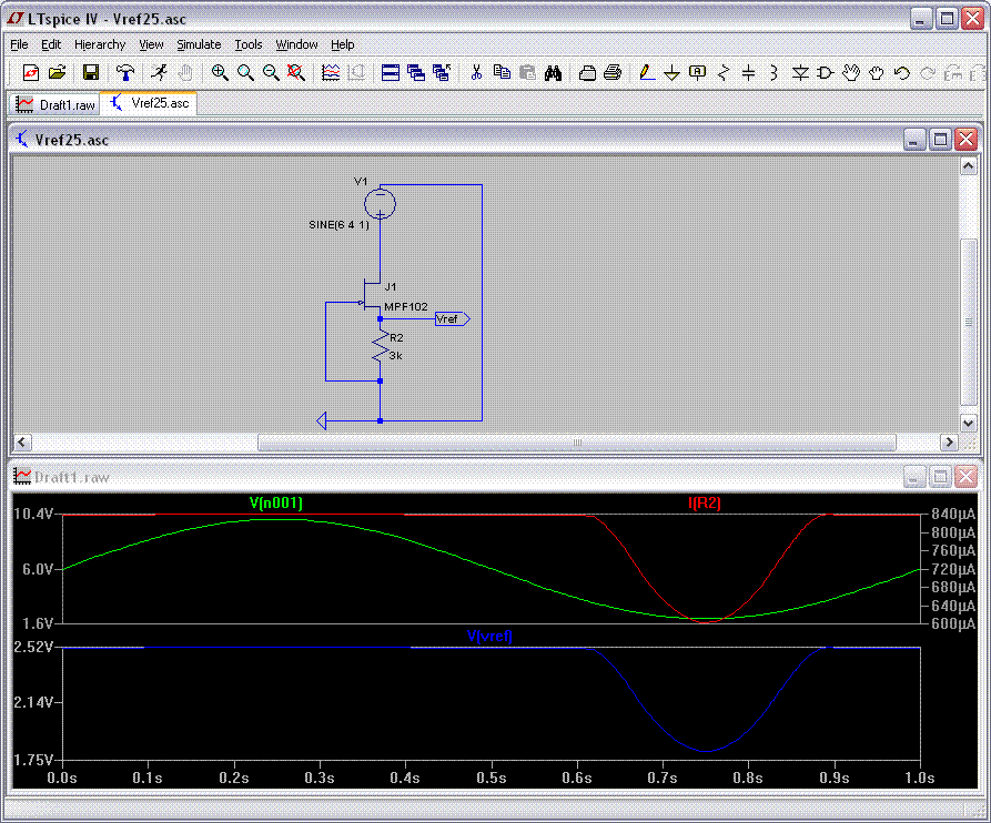

How 'bout this? A JFET current source, and tap a 2.5V VRef off the resistor as shown in the attached screenshot.
In the simulation, it is stable down to about a 3.1V supply voltage, which is more than sufficient. But is it (reasonably) thermally stable?

Add this to your sim:
.step temp 25 50 5
or whatever you want. This will run 6 sims, starting at 25C, ending at 50C, in 5C steps.
You can also do a DC sweep instead of a transient sim. Set the supply voltage to some arbitrary voltage, then sweep it in small steps. I did 0 to 5V in 1mV steps. You get a nice plot of Vout vs Vcc.
Even better than SPICE is an actual breadboard. With an actual MPF102 and using a 3.9k in parallel with a 180K resistor (giving me an actual value of 3.77k according to my multimeter) I get 2.500 volts on the dot.
As for temperature stability, I only saw a change of 1mV when I touched an ice cube to the top of the FET. ;) I think it's good enough for my purposes.
EDIT: I spoke too soon. I had 2.5V at the output when I fed the circuit with 5V. When I feed it with 9V, I get 2.532V. Not exactly self regulating voltage wise, and not what I got with Spice...

Why would you test over such a wide range? Can't you power it from your 78L05?
Well, if you built a voltage regulator or reference wouldn't you test it over a wider range than you'd see in the actual circuit? My simulations showed it to have a steady voltage over a wide input range.
Also, one of the purposes of this reference is to be able to detect a low battery by detecting sag on the 5V rail. So if I run this reference off the 78L05 and it sags as well, it won't work too well for that purpose. Otherwise, I'd just use a voltage divider off the 5V to get my reference.
But that is a good point... I should test it between 4.5-5V to see how much the output varies over that range. But, in theory at least, the output voltage shouldn't change, if you run a constant current through a fixed resistor, you should get a fixed voltage, right? (as long as the input voltage is high enough). Ohm's Law at work.

Yeah, that was my point. Test over the range that you expect to see.
A single transistor "constant" current source will never be absolutely constant as a function of Vcc.
