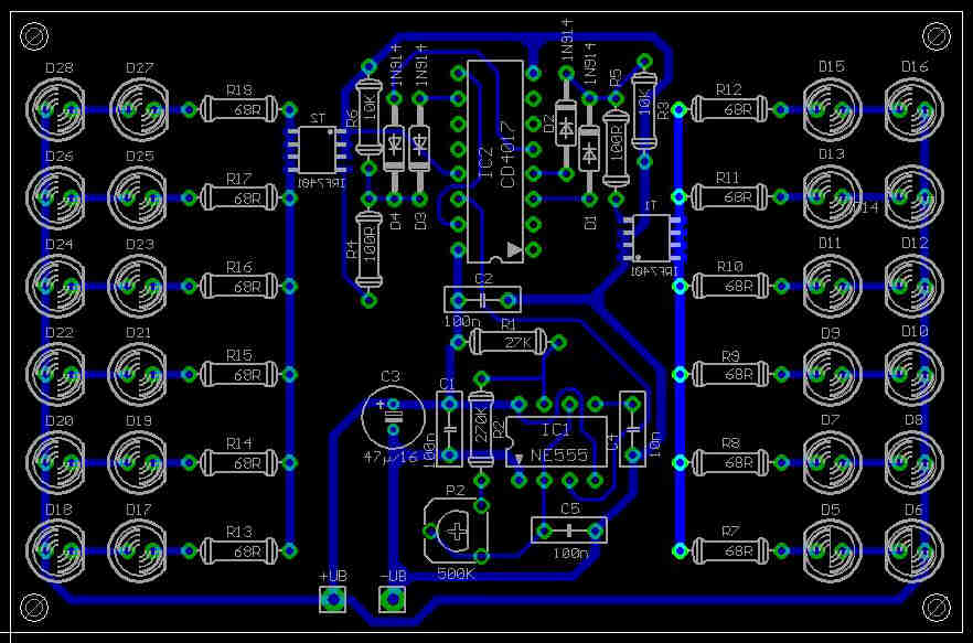

okay sorry i forgot ill be using a 2 led for left side and 2 led for the rigth side. so that it will flash 3L & 3R:D and also ill be using a battery.
Hi Marvel,
I picked up the idea as shown in the video. The design uses two LED arrays of 12 each.
This is a dual flasher circuit.
It uses IRF7401 MosFet transistors in an SO-8 package. Soldering shouldn't be a problem because one complete row of pins must be shorted anyway (drain pins, see highlighted trace on the R/H side). There are three source pins (2-4) which must be shorted as well.
Board size is 3.77X2.47" (single sided)
Boncuk

Hi Marvel,
Boncuk
thank alot body :( i was hope i can make it blink trice:D thanks you so much;)
I'll have to build the circuit first and check if it works the way the simulation showed.
When it's done I might forward the Eagle files to you.
You might also build the circuit on your discretion.
