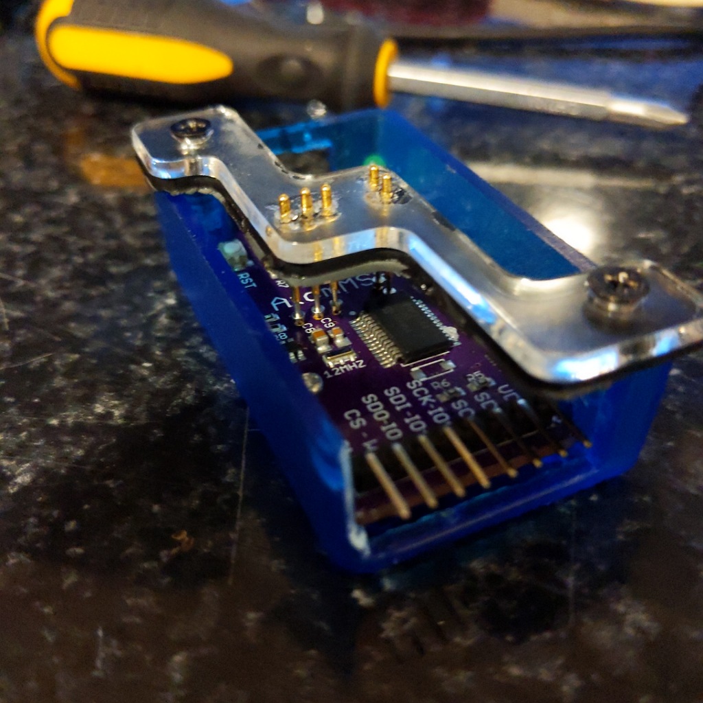

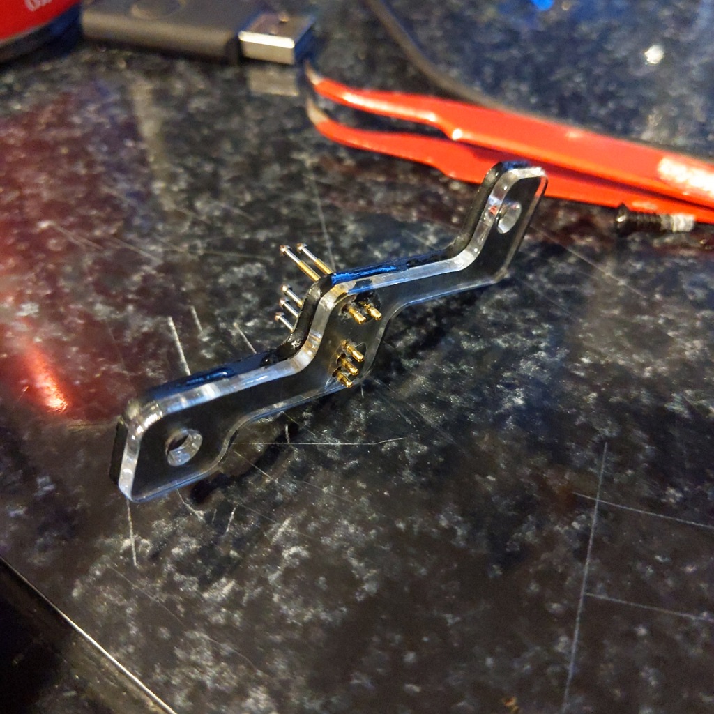

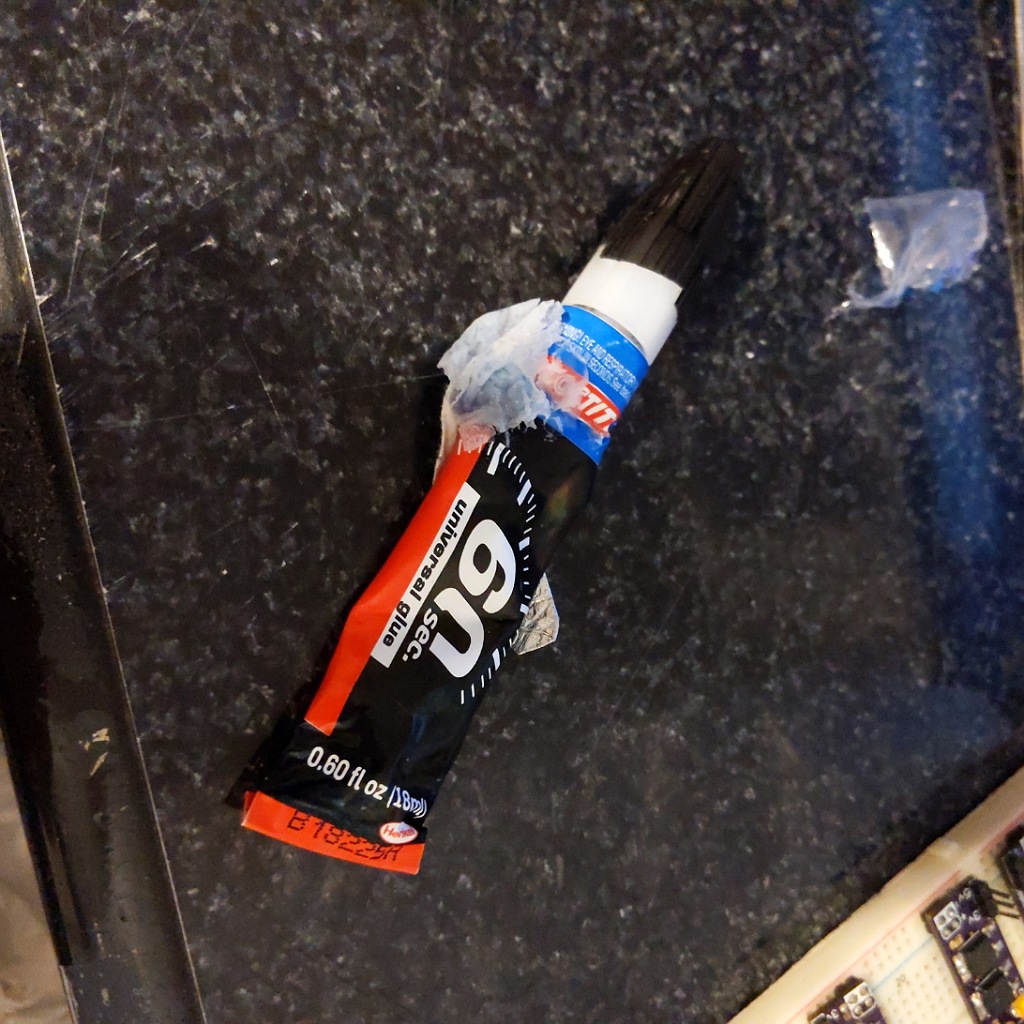

Hey guys I failed to mention I'm using a laser cutter to make it. I actually found some old 60sec universal glue that seemed to work great.

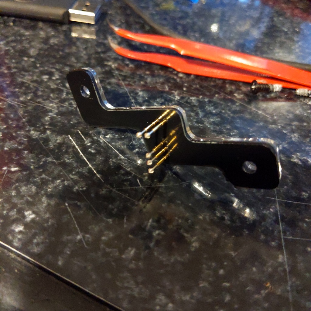

Also...

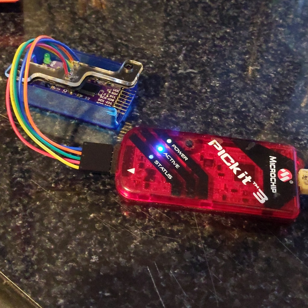

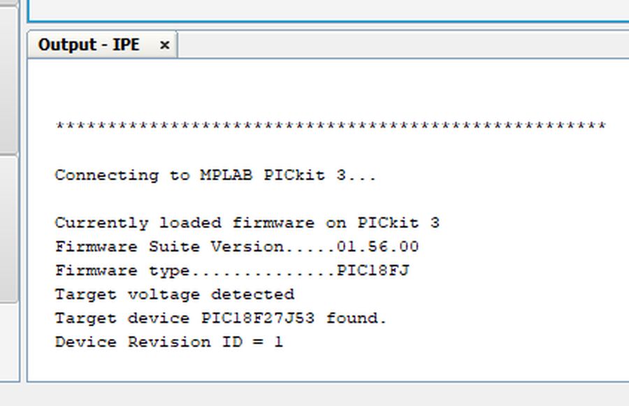

Finally.. .. of course I have it powered from its own USB port.. which isn't tied to USB of pic but a cp2104.

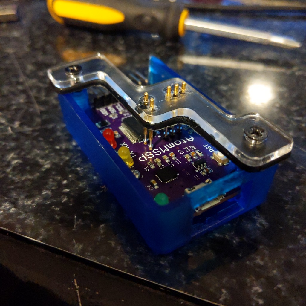

At the risk of been obvious?, why not just have a row of pins on the PCB that the PICKit pushes on to? - that's all I do. For production boards, using through hole PIC's, I leave the pins out and program the PIC before soldering it in (using a ZIF adaptor) - if it needs updating in the future, I can solder the pins in afterwards, or even just hold them in place while it programs.
Hey Nigel, i understand that. I just wanted to make the board a certain size and i left the ICSP for last and totally forgot about it. So i ended up using little space i had left without having to redesign anything at all. This saved me time at that moment. Also i like the fact that its not too easy to reprogram. Makes it feel more professional lol i know thats just silly but ... meh...
This pcb is already made.. months ago to be honest. Just now with Virus all up and about. im stuck here and might as well play a lot with what i have. Ill make Revision 2 with a quicker ICSP port. Hence the other post about the bootloader stuff., one programming of the bootloader would allow future updates. So ICSP wouldnt be a hassle... just need 1 unit for debugging.
I might see if i can make my own bootloader or switch MCU to something popular with a premade bootloader. Not sure yet.. Lots to read. I honestly have Linker stuff and Interrupts etc....
I played with bootloaders a LONG time ago - the PICKit2/3/4 and MPLAB have really rendered them pretty pointless, and any bootloader is always going to be a waste of space you could use for your main program.
That is true. But i do plan on selling some products in the future and would be nice if it wasnt a hassle for a user, even if they are PIC friendly.. didnt have to use a PICkit to reprogram it. Would be nice simple app on PC with USB to UART.. few seconds and bam! update installed.
