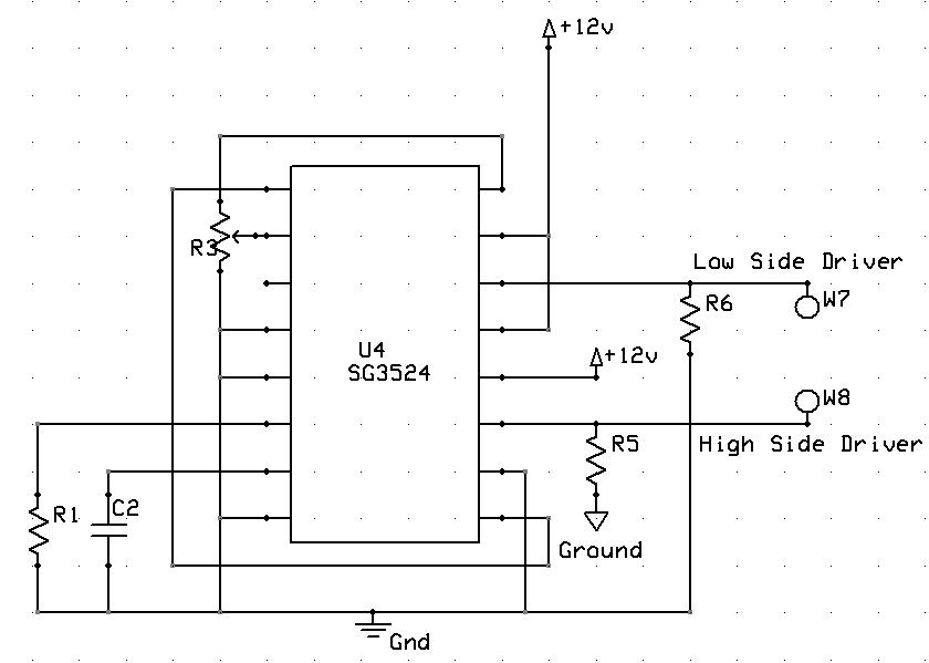

Here is the oscillator schematic. It uses an SG3524 PWM, the power supply connections to the right of the chip are for the floating supply as not to short out the output. R1 and C2 adjust the frequency.

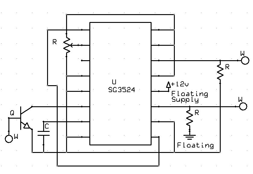

OK, this is going to be the 'VCO' right? So R1 will need to be a BJT as a current sink, it's base becomes the VCO control voltage.
What's next on the agenda then?
Phase comparator? Loop low pass filter? Crystal controlled reference frequency generator to synchronise this VCO to?
Ok, I will change the schematic to add the BJT in place of R1. Also I will use a XOR logic gate as my phase detector, that will be posted soon.

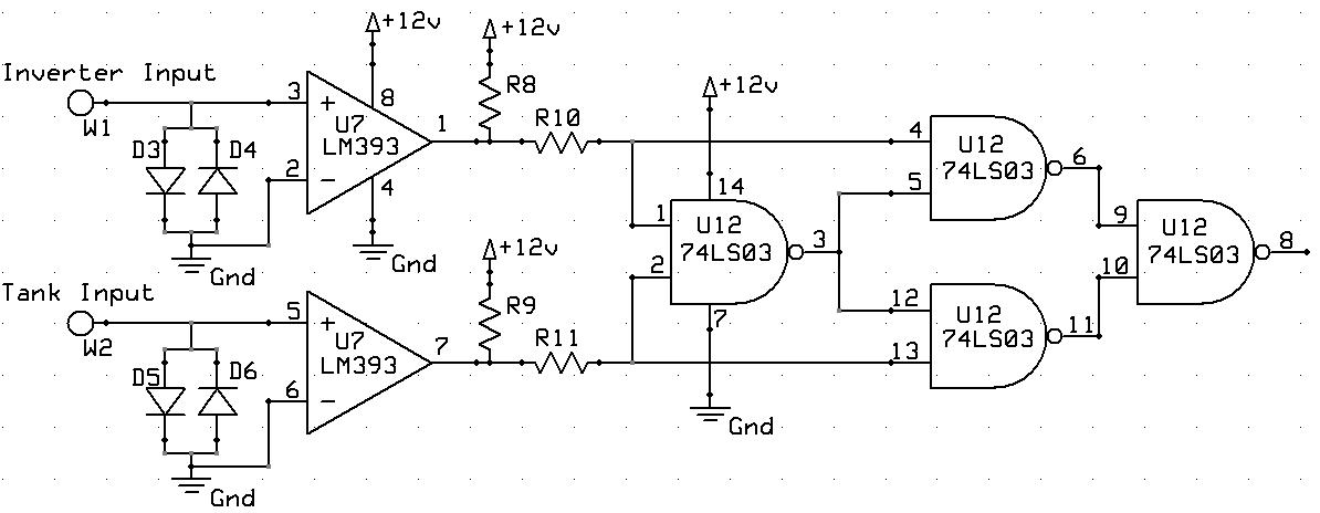

Here is my phase detector, how can I connect the output of this to my VCO?

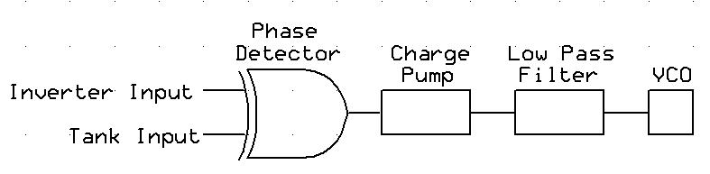

In an analogue PLL, the phase comparator feeds the VCO via a LowPassFilter. It's an L-Pad. It's capacitor has a resistor in series.
You're suppose to calculate the LPF, and there's a fair bit of maths, but you can tune 'by ear' instead with a scope if make the R's variable.
So, what you going to synchronise the VFO to?
And, Is there a block diagram you can post yet? (kinda important!)
edit: I believe you're going to use the instantaneous phase of the output LC as the other input to the PC.
If so I assume the object of the PLL is to null the phase lead/lag between the (VCO) driven IGBT (active) phase and the LC (passive) circuit phase.
