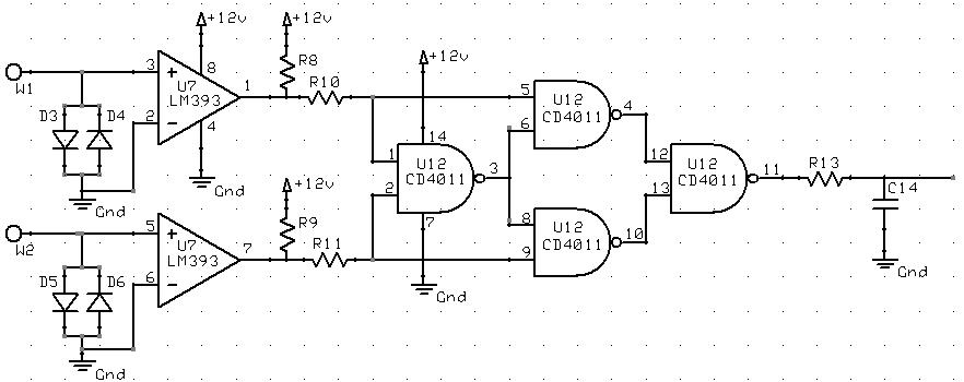

Yes, I dont really know the best way to design the charge pump, do you know of any schematics?:)
It's just the "LPF" I mentioned earlier. Follow it with a unity-gain buffer, which drives (via a pot-down) the base of the transistor. The transitor that replaced R1 in the SG chip.
Open-loop condition for testing...The added transistor base circuit: you want the VCO to vary over your total expected range of frequencies plus a 'bit extra in case', according to a 1 V to 4V DC signal, that comes from the UG buffer. If you add a series resistor under the emitter, VCO be more linear and controllable.
Here is the phase detector with a LPF.

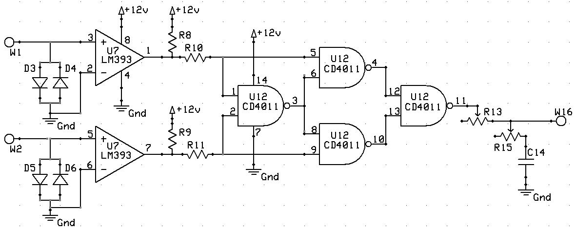

put a var. resistor in series with C14 and make R13 a var. res. too.
5K, 0.1 uF, 100K
the ohmage in series with the cap deliberately creates phase jitter. You'll need some phase jitter, or your loop will resonate too much

Here is the updated schematic, I added the two variable resistors. Can I connect W16 to the base of my transistor on the oscillator now?
