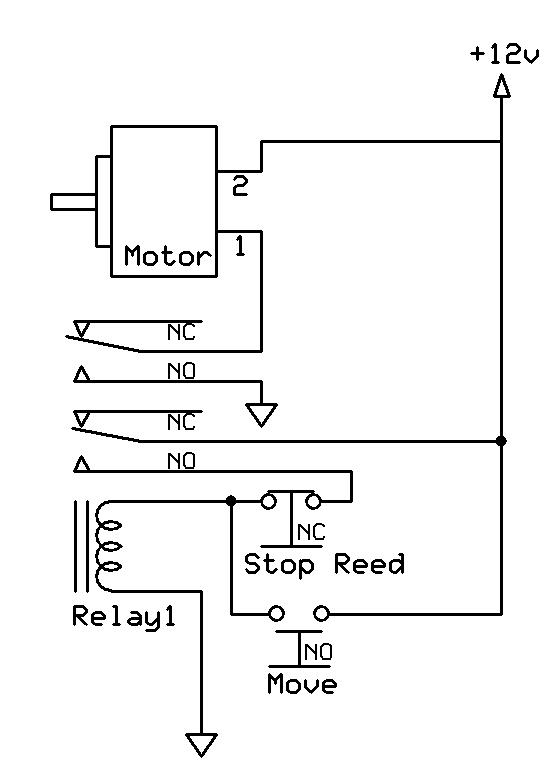

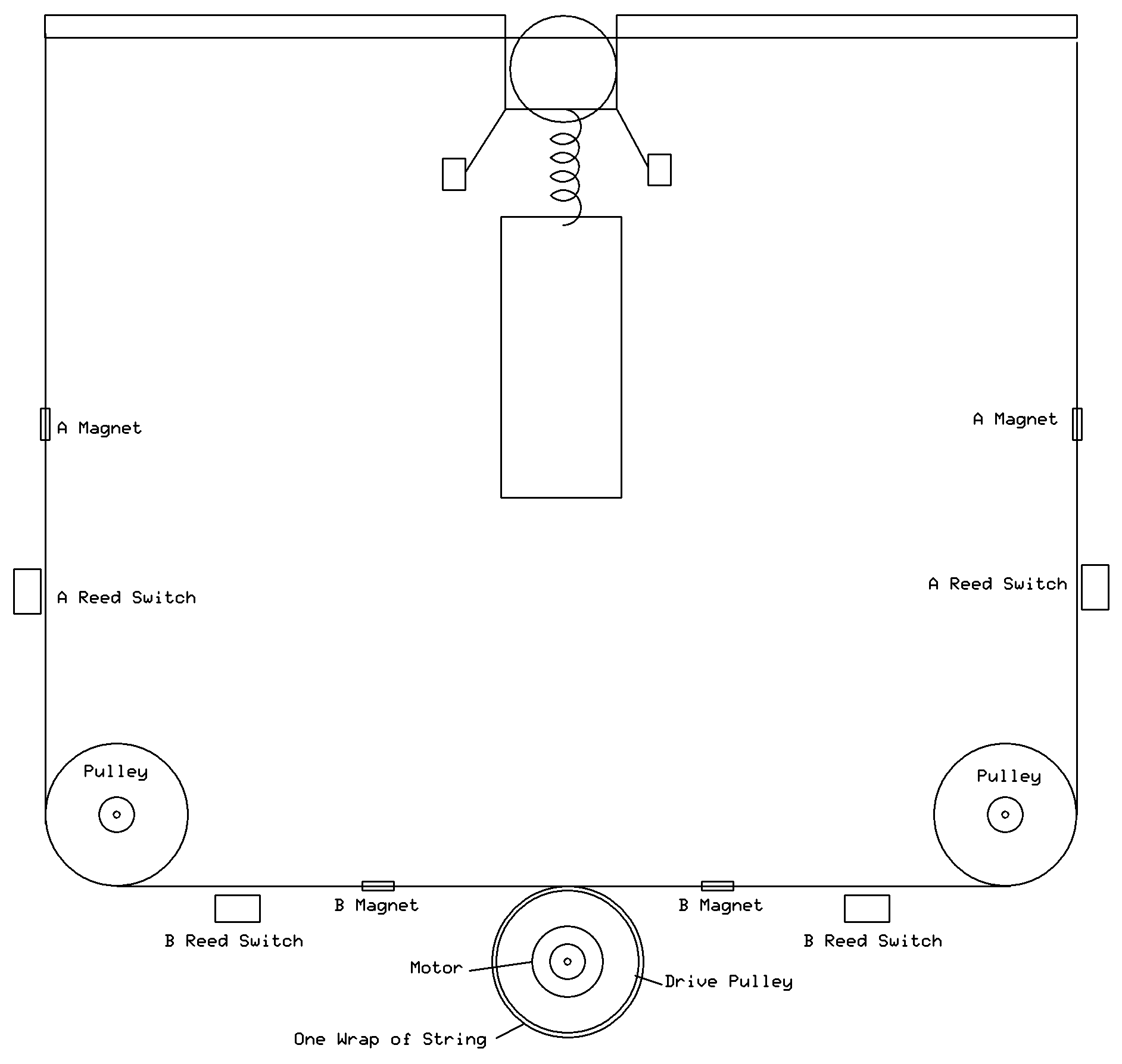

OK here's my mind's view of the mechanics with a circuit that changes motor direction, based on my original circuit with one N.O. reed and one N.C. reed. The reeds and magnets marked "A" are one possible location, and the ones marked "B" are another. Whichever is more convenient.
Ken

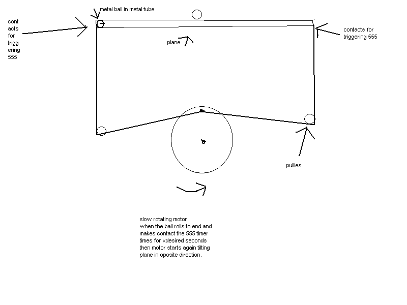

easy solution w/o fancy switches
a metal tube with metal ballbearing.
plane tilts, closes contacts, triggers 555 for desired off time. motor starts again and tilts in oposite direction and stops when ball makes contact.
the flashing lights = add another led and resistor from (v+ to pin 3 output)
then you have alternating flashing lights.
can you use a 556 (2-555 in one package)
you must use a very slow rotating motor or a different pully combonation to achieve a slow tilt.
you could bend the tube slightly so the plane will tilt more before contact or have 2 magnets on the large wheel connected to the wing strings then when the magnet closes the reed switch contacts the motor stops (trigger the 555 timer.

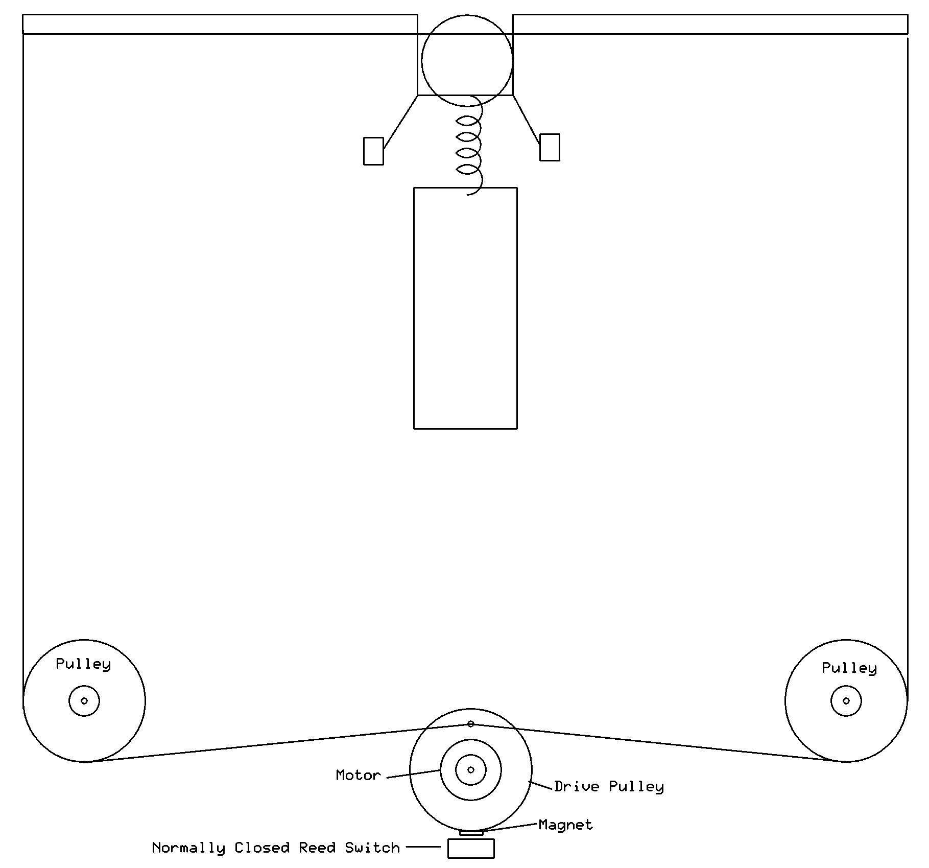

OK, another possibility. Still requires one normally-closed reed switch, but the motor only turns in one direction. The circuit allows you to push the button, the motor banks the airplane >left>level>right>level>stop.
Is this do-able?
Ken

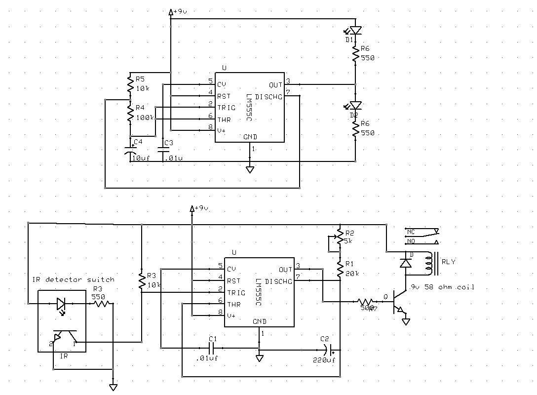

simple IR switch
using the post with two pullies but you don't need the metal tube.
the wheel attached to the motor has 2 narrow slits 180 degrees apart so when the IR switch conducts it triggers the 555 (momentium should close the IR switch using very narrow slit so 555 can time out and restart motor.
the flashing lights alternate at .68hz
one motor, one switch. install pushbutton between pin 2 and ground to start timmer.
the relay is connected to motor. you might have to recaculate the base resistor
NOTE I have wrong transistor should be PNP so motor is off durring the 555 on cycle. move the relay to the emitter not collector.
Do some work by searching about transistor switches.
