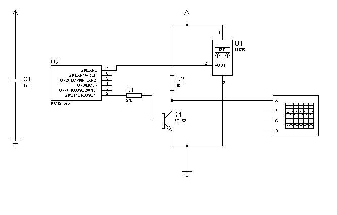

Please help me in making codes in PWM temperature controlled fan via PIC12F675
Here's my circuit.
Sir thank you soo much :) I really do appreciate it a lot lot lot :)
Sir can i ask for a little more? my proffessor also obligated me to have an LED sensor. Lets say an YELLOW led for a normal mode and when the temperature reaches above 50degrees it will be red. How can i suppose to put it in the program siree?
Siree i follow the circuit you drawn but i think it doesn't work well? because the pwm/duty cycle is not changing. when i plug it in it comes in full blast from the beginning till the end :(

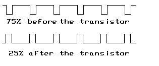

The transistor acts as an invertor so a wave output from the pin looks like this
To swap the signal so it is correct at the motor.. You make the Ontime the Offtime and visa versa.
