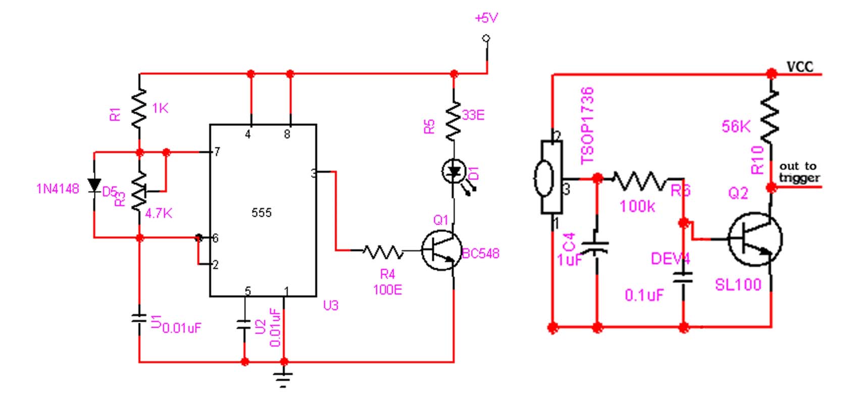

Please explain capacitor action in this circuit
haxxx
I found this circuit which detects guest arrival.
Could anyone please explain the action of the capacitors, in the circuit on the right, when the path between the led and the tsop1736 is broken.
Also the datasheet for the tsop suggests using a rc network across pin 1
and 2 of the tsop to suppress power supply disturbances,
Is it unnecessary in the design of this circuit or inadvertently omitted.
If so is there any harm in me adding it.
Thnx.

The datasheet for the 555 and for the TSOP show a supply bypass capacitor. The TSOP is fed through a resistor.
The TSOP reduces its gain if you send it continuous pulses. Then its range is reduced. The datasheet shows bursts of pulses then a pause before the next burst of pulses to keep the gain high.

Also i was asking about the capacitors in the circuits i attached.

If i understand u correctly and based on the graph in the datasheet, the
555 delivers the square wave output with necessary
pauses so the tsop can distinguish its signals from ambient light, my question is, wouldn't the resulting high and low output cycle from the tsop equal a false trigger to to the transistor, clearly it doesn't i just want to know why.

The 555 delivers a continuous 36kHz signal exactly like a compact fluorescent light bulb which is interference. The TSOP has automatic gain control that expects bursts of remote control data for the gain to remain high. When continuous 36kHz IR puses are detected then it reduces its gain which reduces its range so that the interference is reduced.
You need a second 555 to turn the 36kHz one on and off like bursts of data for the gain and range to remain high.
You need to filter out the bursts in your application.
Are you saying, as the circuit is, it won't reliably do what it was designed to do, essentially a low off the collector when the beam is interrupted.
It will, but its gain will be reduced then its range will also be reduced.
It needs the 100 ohm resistor and 4.7uF as I showed and as shown in its datasheet.
