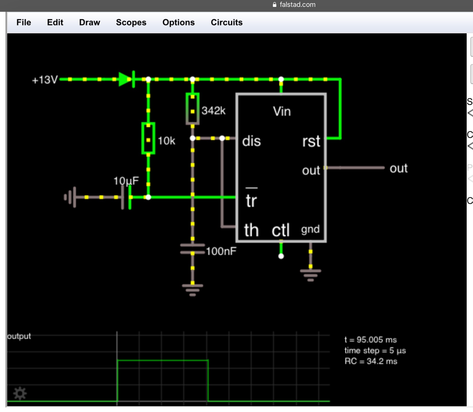

Hello, i have made a couple of 555 timer circuits before that worked well, but this one is a little different because it must only be able to trigger no more than once every few hours. This circuit seems to work correctly according to the online simulator i tried, but i don’t know what value the capacitor on trigger pin 2 should be. I used 10uf, maybe that is way too big?

The 13v supply is also supposed to be the trigger, and the output only stays on for just over 4 seconds. The 342k resistor is actually a 100k + 242k vr in series for adjustability down to about 2 seconds.
According to the simulator this works ok.
I put the 10uf capacitor on the trigger pinonly to keep the trigger high for roughly a few hours, so the output cannot be triggered more often than that. Maybe even 1uf would be plenty, I haven’t experimented on my breadboard yet, and I don’t know how to calculate how long that capacitor would keep pin 2 high for?
You don't how to calculate it, because it won't work - you also don't do things with 555's in 'hours' anyway, minutes is pushing it and requires HUGE capacitors.

I don't see as it's going to keep it high at all?, and even if it did, it would be for a very short period.
However, the pin is held high by the 10K resistor, the capacitor will hold it low very briefly on power up, and then go high as the capacitor charges. It will then stay permanently high until power is removed.

With 10uF value shown, the lockout period will be about 60mS past when the 13 Volts drops out. If that is the time period that you need to extend, the you'll need to increase that value by a very large margin. The problem you'll run into though, is that electrolytic capacitors suffer from internal leakage currents that cause them to self discharge over time. That's always been a fundamental limitation in using 555 circuits in long period timers.

Read the datasheet of a 555 timer to see that your circuit does not work the way your simulation wrongly shows. The 342k resistor and 100nF capacitor produce a timeout of only about 0.038 of a second, not 4 seconds. But since the 10k and 10uF capacitor on pin 2 over-rides the other RC parts, the timeout is actually about 0.11 of a second.
Your 100nF capacitor must be about 100uF (1000 times more) for a 4 seconds timeout. Your idea to prevent re-triggering will not work.

Did you read the datasheet for the 555 and do the math?
342k x 470uF x 1.1= 177 seconds. But 342k x 10uF x 1.1= 3.8 seconds. 342k is not a standard value but 360k is standard and with a 10uF capacitor the timing will be 4 seconds. But an electrolytic capacitor needed for 10uF or more is not accurate.
The datasheet for an ordinary LM555 or NE555 shows that the timing resistor can be as high as 10M ohms. Then for 4 seconds, the resistor can be 3.6M and the timing capacitor value should be 1uF. Use a film type of capacitor for accuracy and for it to hold a charge for a long time.

A delay in the order of hours might be a bit too long for a 555, capacitor leakage might well mess up the time period, or stop thing thing from working altogether.
If you can still get them in your area a 4541 might be a better option, for a delay of hours this would be better as the oscillator can run faster and then the delay then multiplied by the built in counter.

My circuit is working fine btw, with the small changes i mentioned above, except for a 100uf instead of the 470uf. The exact value of the capacitor between pin 2 and ground depends on the type/quality, I had different disabled times with the same voltage and uf across different brands of capacitor, some had so much leakage they only lasted minutes!
The circuit is for a car and meant to be disabled for a few hours without power connected, so it will ignore any multiple retriggers, and only be active if the car is left alone all day or all night.
The circuit seems consistant and fairly accurate, but of course if i was to carefully check with a stop watch there would most likely be some variation in the disabled time, but that doesn’t matter. The output time is very accurate since it’s short and the 100k + 242k vr combo is fine.
