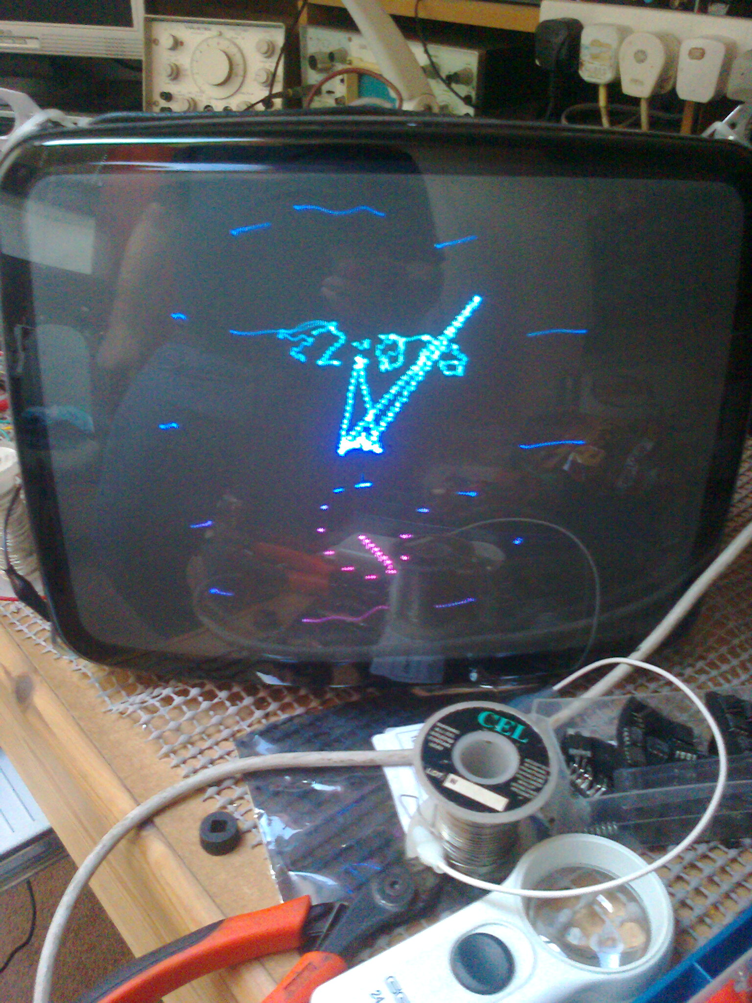

Well I used my 'scope clock as an xy source for the monitor.
This shows the importance of slew rate, the x defelction amp blew up si I replaced the dead tda2050 with a la6500, the latter only has 0.1v/us slew rate, and you can tell as the dots that represent the hours are just wiggly lines.
The colours are washed up as here the tube is running without the convergence and purity magnets, the deflection module probably isnt in the right place either, but it shows it doesnt take that much for an xy monitor to work, just the blue cathode is connected.
The out of round bottom left is dues to a magnet missing on the cover of the deflection coil pack.

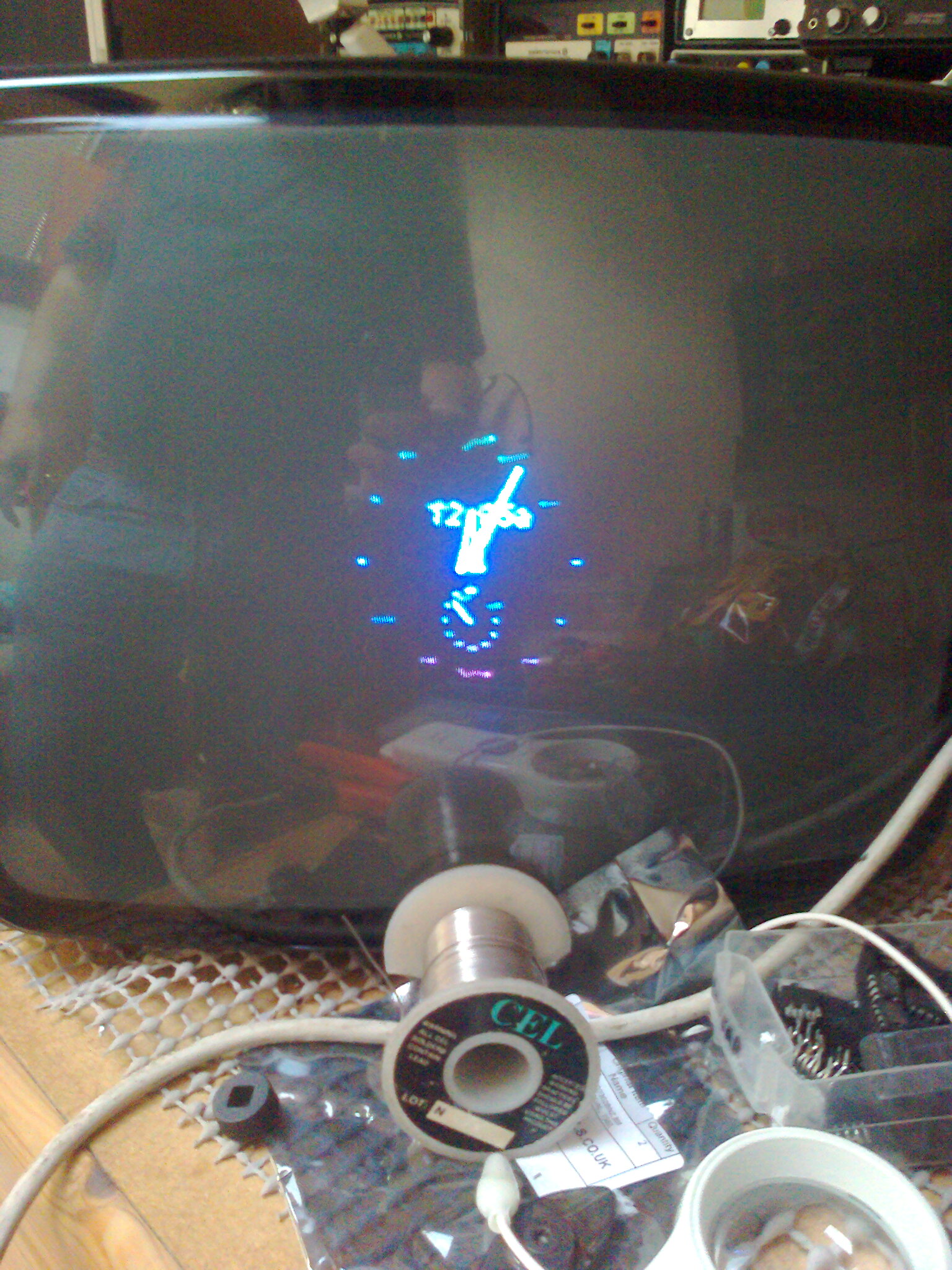

I connected up a tda7265 stereo amp to the xy coils and it is much better.
However as th epic shows I get squiglles at 12, 3, 6 and 9 o clock positions, I think this is due to cross talk, at these positions one of the axes has just gone to zero and the other to max, I suspect that the coil that has gone to zero is ringing and the ringing voltage is being conducted to the other axis.
Might be due to the layout being breadboarded.
There is 47 ohm resistors across the coils to damp ringing
I'm going to try dc offset, then maybe connect the amp i/p's to a square wave and 'scope the coils to see what going on.

Sorted now, the squiggles on 12,3,6, and 9 are sposed to be there, they looked wrong as the correction magnets being missing is messing up the screen making them look like errors, they look ok on my 'scope in xy mode.
Fair amount of warmth from the stereo amp, but when you look at the size of the 'sinks on a amplifone vector monitor it makes sense, the amplifones are hooge.
The text actually looks really good, just like 70's arcade vector graphics.
