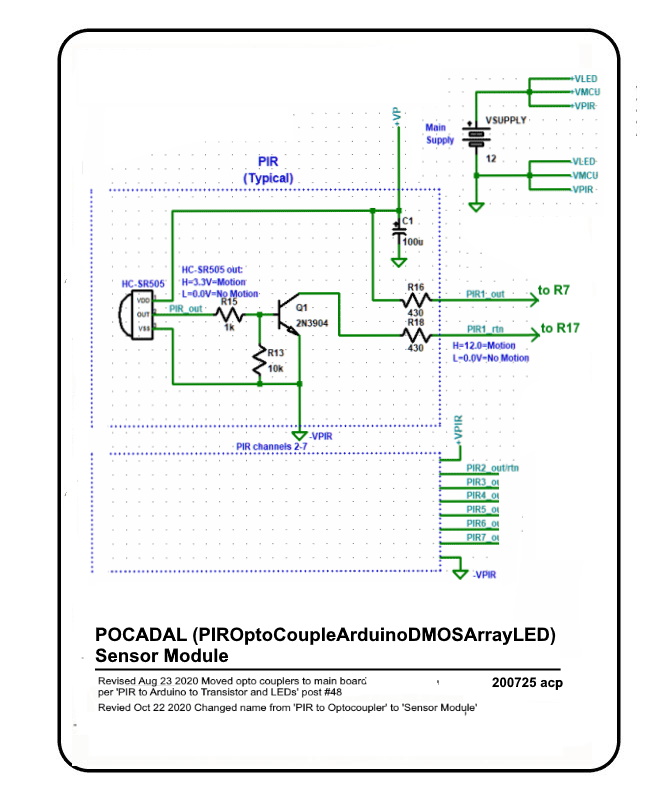

1. The wires (some of them several feet long)
go from the two position fixed terminal blocks
(FTBs) on the Sensor modules and are received by
two position FTBs on the Shield marked
'IN S1 RTN' thru 'IN S8 RTN' on schematic
marked 'REF: 202026 Rev 2020/1028'.
Correct.
2. The 'IN S1 RTN' FTBs go to sixteen 430 ohm
resistors and to the anode and cathode of the
optocouplers. The emitters of the optocouplers
go to ground. The optocoupler collectors
go first, via traces on the shield, to the
Arduino input pins, and second to a 22k
resistor and then to the plus five volt
pin of the Uno.

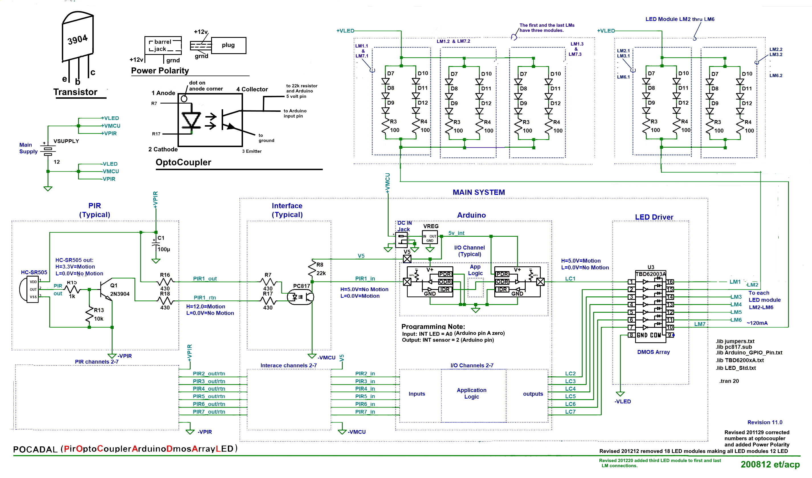

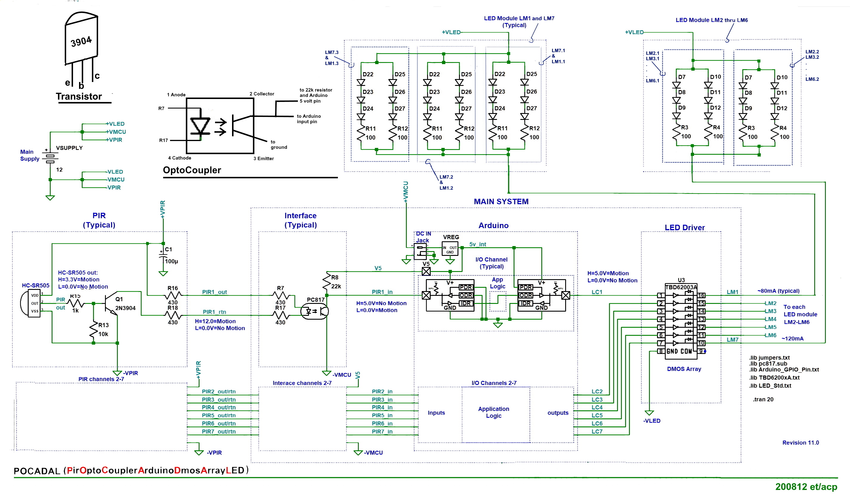

And the final question. In the complete schematic
which will be posted here in the post, so it doesn't have to be dug out of the zip file,
in the wires between the sensor module and opto_coupler, the
wires are marked 'PIR1 out' and 'PIR1 rtn'.
The 'PIR1 out' is understood. This the signal
going out from the sensor to the opto-coupler
and the Shield.
But (assuming that 'rtn' is 'return' at 'PIR1 rtn') what is
being returned? The trace marked 'PIR1 rtn' is going to
the collector of the 2N3904 so don't understand
how and why something is being returned to a transistor
collector.
Thanks.

what is
collector.
It's a "Current loop" driver. The transistor switches on or off current (set by the resistors) to the LED in the opto isolator.
The labelling does not change how it works.
From the LED half "point of view", you could say it has a + supply and - return, while the transistor is on..
It's virtually a clone of a standard current loop as used for MIDI instrument interfaces.
See the schematics on this page as an example - they are split between the driver and receiver as it's a plug-together system, but if you look at the two haves together it's pretty much the same setup as in your drawing.
I still don't understand why there are four 430Ω resistors in series with the opto LED.
which will be posted here, so it doesn't
have to be dug out of the zip file.
On the traces between sensor module and opto_coupler the
wires are marked in green font: 'PIR1 out' and 'PIR1 rtn'.
(Just above blue font:
'H=12.0=Motion
L=0.0v= No Motion'
and the Shield.
But (assuming that 'rtn' means 'return' at 'PIR1 rtn') what is
the collector of the 2N3904 so it is not understood
how or why something is being returned to a transistor
collector.
Thanks.

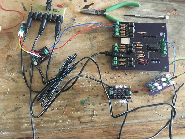

Hello ETO forum,
Got the boards for the staircase project loaded and connected
using the tested schematic:
Here's a photo:
Test one PIR to Arduino and LED DMOs
1a. Connected sensor S1 to 12v and grnd.
1b. Connected sensor S1 to Out and Rtn at Arduino shield.
1c. Connected LED module ground to DMOS connx LM1 and
+12v at power source.
Expected result: LED modules light w motion at the PIR
Actual result: LED modules do not light with motion at the PIR
Have tried connecting the LED +V to the +v on the Arduino. No luck.
Also unit tested the LED modules and the Sensor module.
See PIR Sensor Unit Test posted herewith below.
Also posted below PIR_to_Arduino_sketch
Thanks.
Allen in Dallas

My first suggestion is to test each module independently identify and localize the problem.
That "PIR test" was presumably from an earlier design, as you cannot possibly get the result it states - so also, presumably, you have not actually tested the PIR modules on their own?
Link PIR OUT and PIR RTN
With power applied, the voltage on that link should be around supply voltage with no trigger and half supply when triggered.
The two 470 resistors form a divider, so the transistor turning on (and collector near 0V) means half way between that and supply at the output, while the jumper link is in place.
If connected to the opto on the next board, the PIR OUT voltage should drop slightly, a couple of volts or so, and the PIR RTN voltage drop rather more, down to 2 - 3V, when triggered.
