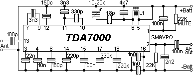

got some more questions about a schematic of a receiver that i am going to build.
1. What does pin 13 connect to?
2. Why are all the pin numbers all over the place on this schematic?
3. To the left of pin 6, there are 3 capacitors, the 18 pf and the adjustable cap, and then the 4.7 pf in parallel with those. Do I have to have all of these caps? I'd like to just make my own LC circuit. I have a couple 3-56 pf tunable caps. Can I do this?

The pin numbers are "all over the place" to make it easier to draw, and you don't have lines crossing others leaving you to wonder if they're connected or not..
Pin 13 goes to the antenna thru a capacitor. The picture I posted would be easier for you to follow. The pins are where they are suppose to be.
You know this is a Mono FM Radio and you need an Amplifier on the output to hear it.
Then what is that other lead right below it? Are they both connected to antenna? that's wut i thought at first
Thanx :D
It's the positive battery connections (follow the line), the two terminals connect to either side of a dipole aerial. You could use the negative supply rail, which is more usual, but they are identical as far as AC is concerned.
