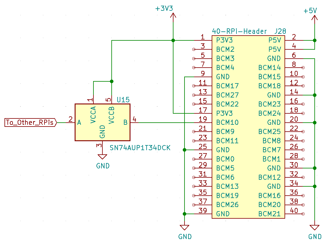

My latest thought is I could possibly use voltage translator. Something like this SN74AUP1T34.
I think I could tie the VCCA, and VCCB pins to 3.3V on the RPi. So, if the RPi was unpowered, I could toggle 3.3V on the A pin all day long and the unpowered RPi's GPIO connected to pin B would never see it. I don't think it would damage the translator to have 3.3V applied to pin A and 0V on VCCA, at least a quick review of the datasheet didn't seem to indicate that.
I'm thinking adding a series resistor between B and the GPIO wouldn't hurt, but probably isn't strictly necessary.
There are also other translators out there with an EN pin like this one PI4ULS3V501TAEX. Not sure if it adds any value or not.
Thoughts?

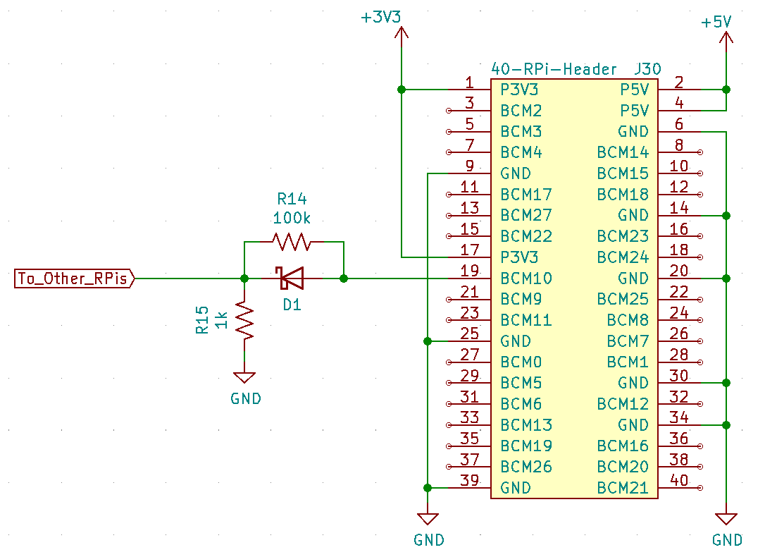

How about this?
A common point with a low value pulldown resistor, eg. 1K or lower, whatever a Pi output can still pull up to full voltage.
Then from each Pi to that, a 100K resistor in parallel with a schottky diode.
The diode allows any Pi to pull the pin high when it is master; otherwise the Pi pin is an input with no internal pullup, so near zero load and the 100K has little effect - but no harmful current can ever be passed to a powered-off device, or between two powered devices that enable the output at the same time.
Ideally, have the 100K + diode combination close to the Pi it connects to, to keep the high impedance part as short as possible to minimise noise pickup.
I don't like the name of that chip "1-bit Unidirectional Voltage-Level Translator" sounds one way.
You're right. That was a mistake on my part. The SN74AUP1T34 won't work. What about the PI4ULS3V501TAEX?
Yes, I can have software differences. The 245 looks promising except for the direction control pin which could complicate things. I haven't really thought that through yet.

This is an interesting idea. If I understand what you're proposing, I'd still be back-powering the unpowered RPi in the sense the unpowered GPIO would still see 3.3V, but the 100k resistor would limit the current so low nothing would result from it. Except for the addition of the schottky diode, it sounds similar to what Nigel proposed in post #2.
Does the schematic below accurately represent the idea?
Yes, assuming you also have a 100K and diode in line with every other connection to the 1K common point.
(And only the one "global" 1K pulldown).

The diodes are arranged so that the pin can't go above supply voltage or below ground. So, the pin will see 3.3 - Vf of the diode. The 100k should stop the chip powering up so it shouldn't be a problem. Maybe a 1K resistor across the supply (of the unpowered pi) will reduce any voltage below the brown out voltage of the chip.
Just done an experiment and the inputs will go to near supply on an unpowered Pi even though fed through a 100K resistor! The Pi GPIO pins do not have input protection diodes...
To be 100% safe, add another schottky diode from the I/O pin to a 3.3V power pin, on each Pi connector.
That should guarantee no out-of-spec voltages appear.

I was planning on having an identical circuit on each RPi, including the pull down. The hardware needs to be identical. The only differences can be in software. I understand this means I'll have a whole bunch of pull down resistors in parallel, and I'll size them accordingly.
I'm not sure I follow the 1k resistor bit. You mean connect a 1k resistor between 3.3V and GND on the RPi?

So you're proposing adding another diode from the GPIO forward biased toward the supply to ensure the GPIO is never more than Vf above the supply voltage? That'll still drive the entire supply bus up to nearly 3.3V and "back power" it. Still nothing should happen with the 100k resistor limiting current, and with the added diode now at least it'll prevent the GPIO from going far above the supply, but I feel like we're back to square one accepting that portions of the unpowered RPi will be driven up to 3.3V.
I still don't really like it. I'd prefer to incorporate a solution with completely known behavior, minimizing the times I have to say something like "it should be OK".
Yes, the idea being that a 1k resistor will provide a suitable load to stop the supply voltage from getting above the brown out voltage of the CPU (anyone know what the BOV is?) and prevent it being "back powered"
