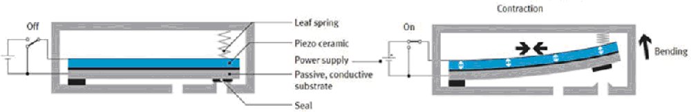

I want to build some pneumatic valves like this.

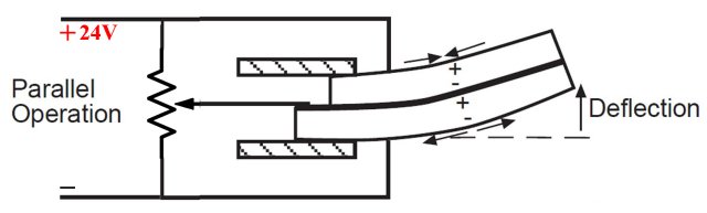

I found general info and wiring possibilities online. Wired serial did nothing.
Wired parallel like this,
I got the 0.002" movement but it is very weak compared to the 50N, 180 Oz. force in the specs. Pressing on a postage scale at 24 volts, I got plus and minus 0.15 ounce pressure with a total of .3 ounce pressure at 0.002" movement.
At 50 volts, .62 OZ. pressure.
At 70 volts, .80 OZ. pressure.
At 100 volts, 1.00 OZ. pressure. But that is way less than the 180 Oz. force in the specs.

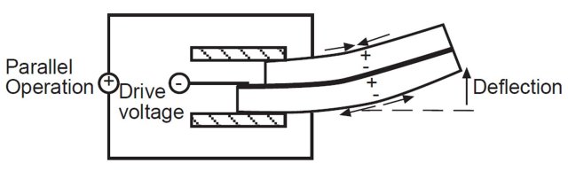

the movement was all in one direction instead of +/- from center and was slightly stronger. At 60 volts it moved 0.002" at 0.80 OZ. force.
Still not close or usable.
Is there another way to drive this thing?
What am I missing?
In the second pic, shouldn't the lower bender be up the other way?
On this picture with the potentiometer, it actually bent above and below the center strait / off position.
I think you are right. I only need 2 ounces or 0.6 Newton. It won't even do that.
There is a mistake.
Notes: Maximum Blocking force @ 100Vpp is 0.2N for
Piezo Ceramic Bimorph 40x10x0.5mm 2 KHz
SMBA4510T05M - 2 Pc/Set
Manufacturer part number: SMBA4510T05M
Yours will be 0.5N
