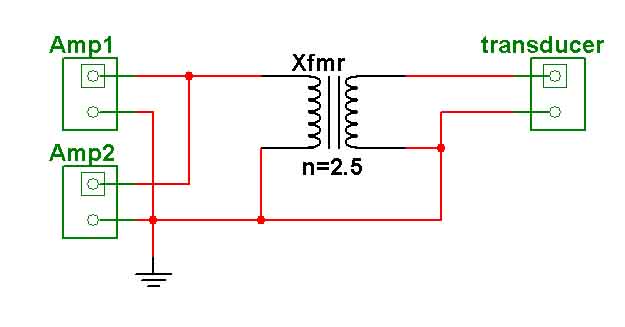

I put the scope on the transducer ... and its actually seeing about 40v pk...
Each amp is supposed to be able to handle 100 watts...
I could invert the input to one of the amps and then bridge them... but then I would lose my ground.... this would give me 80v pk...
Since the trnasducer body is one of the conenctions... I really don't want to sacrifice my ground...
So... wouild it be possible to use a transformer with one side grounded and run the amps in parallel? Here is a schematic...
The transformer ratio would be 2.75... Would a common/standard transformer work at 28kHz??
Thanks,
Michael

Hey~~
Seems like I would need a autotransformer with a powered iron core for high frequency...
Perhaps it would be more efficient to toss the amps and just switch the rectifed mains voltage ... We get 220ac here in South Korea..
But since I already have the amps I think I wil lgo looking for an autotransformer with a powdered iron core...
Could someone confirm that this would be a possible solution??
No, a mains transformer would not work.

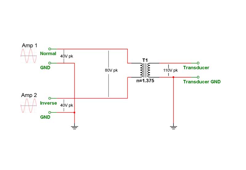

Use a powered iron core transformer with isolated windings. Drive the primary with the bridged amplifiers and the isolated secondary can connect to the transducer and ground. You'll probably have to wind your own transformer. This is assuming that the amplifiers can put out 200W in bridged mode.
Allright....
So I should invert the signal to one of the amps and tie their grounds together.... and drive the primary of the transformer with the signal form amp 1 and the inverted signal form amp 2...
Here is a pic...
Thanks,
Michael

Just Make a transformer. Its not that difficult and definately cheaper than what your proposing below.
A Ferrite "E/I" core would be best considering the frequency involved. And it should be a Power ferrite Material, such as made by "Fair Rite" and there material "77".
Total transformer cost probably under $5.00
And Why would you need a 1.5 Kw Amp to drive this?
Piezos are usually more of a Voltage operated device, rather than high current or power.
