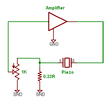

Since the piezo already has a resonant frequency just put it in the positive feedback loop of an amplifier and it'll oscillate at the proper frequency.
I'm not sure that will work as there is a mechanical resonance involved...
I think I would also have to isolate it as its running at 100v pp...
I think PLL is a pretty common method .... I just don't know how to implement that yet....
Assuming the following things:
The transducer is 30:eek:hm: at its resonant frequency.
You want apx 100Vpk-pk out of the amplifier.
The amplifier will output 100Vpk-pk with less than 1Vpk-pk input.
The amplifier can handle a continuous output at that level at 100% duty cycle without blowing up.
You would do something like this:

Hmm..
It seems that 0.33 ohm resistor will have to be pretty big...
Can someone clue me in how I apply ohm's law to calculate the current thru the resistor so I can figure out the power rating for the resistor...?
Using I = V / R ... and then P= I x V .... doesn't give a reasonable value...

The hundred volts will be across the piezo (30:eek:hm:) in series with the 0.33:eek:hm: so it would be 3.3Amps peak current.
100V / (30 + 0.33) = 3.3A
100v peak is 70.7Vrms so the RMS current would be 2.33 amps and the RMS power 164.8 Watts. The power dissipated in the 0.33:eek:hm: resistor would be 1.8 watts.

Kchriste, shouldn't the calucluation be done with 50V peak and not 100V peak...
The amp is being supplied with +/- 50 volts dc....
It's output is gnd & signal ... which is good as it allows me to ground the transducer...
Since the peak voltage is half of the peak to peak?
So... RMS voltage would be 35.35Vrms and then curent would be 1.17A rms..
which makes the RMS power 41.4 watts...
Am I right, wrong or totally confused?
Allrighty...
If my corection above is right... And I want to calculate what voltage I should be driving the transducer at, for maximum power of 200 watts.... then....
Using V = SQRT(P * R) = SQRT(200 * 30.33) = 77.9 V RMS
Which is 110.1 Volts peak .... So I should be running +/- 110 Volts into the transducer...
Is this correct?
Yes, you'd need apx 110Vpk (77.9 RMS) into a 30:eek:hm: load to get 200 watts.
