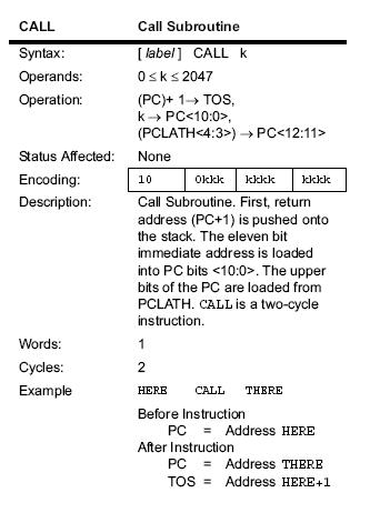

I took a look at the datasheet. As I understand it only takes 2 cyckles both jumps together?
It says quite clearly there, 'CALL is a two cycle instruction', it doesn't mention 'RETURN' at all - return will take at least one cycle, again the datasheet reference to RETURN will tell you.
