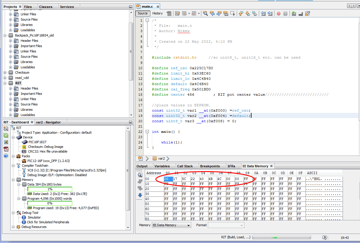

As a little excersize, I converted the first part of your code to C. Namely the equates and the EEPROM defaults.
This is the result,
I'd like, with your permision, to convert a little more to C out of curiosity.
This is the result,
