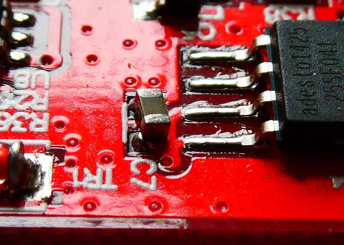

Looked inside the Pickit3, see image and C7.
I'll re-solder it and re-test.

I soldered Pickit3 C7,but it still didn't work.
I decided to re-flow the PK3 board. I had to remove the through the board pin connectors, and my de-solder sucker's recoil threw 4 components off the board :)
Found a schematic, which was the same, (so if it's a clone it is pretty good,) checked where the components went, and heated it up again.
Retried it =PASS :) (it still could have been my settings?)

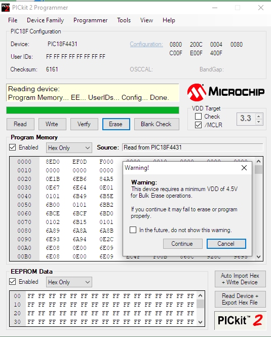

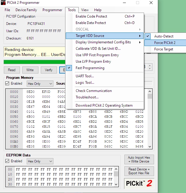

When the PK2 detects a pic, it sets the pic number, and the powered voltage. When set to ERASE, it reports low voltage, see attached. Once set to 'force'pickit, it ERASES ok, also programs.
Noting the voltage required fo programming the 18F4431 is >4.5V, I checked the compass voltage max =4.3V, so went safe and set PK2 to 4V. This now progams (hopefully) and is within the AK8963C voltage.
