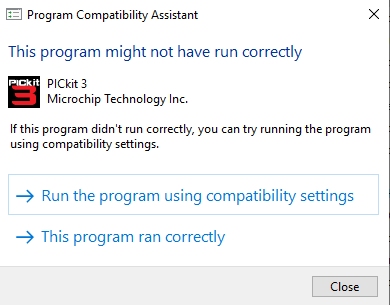

This 'pop-up' just popped up:
C.

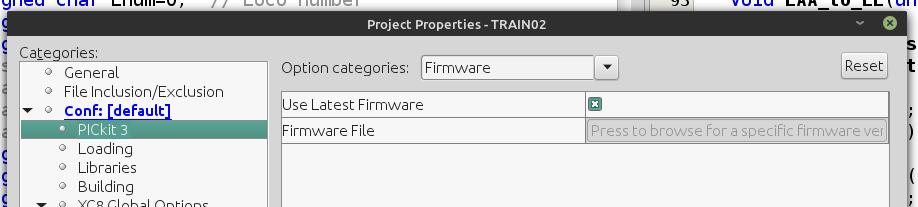

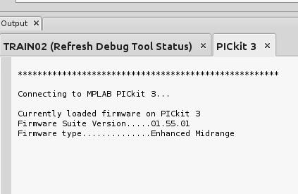

Hi C.. Re the PK3 firmware ....click the green circle arrows, second top left of the Dashboard. for refresh Debug Tool Status .
The [x] set in the project config for PK3 will load latest firmware,
I don't think that is your problem you need to sort out the other CONFIG settings.
Go to [Window] click Target Memory Views . And Configuration bits. that will display your current setting and can generate code to paste into your program

What was the PK3 firmware version ?

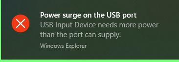

Today, I noticed this pop-up, which could also be adding into the mix.
I had a pickit3 fail on me a couple of months ago and found a diagnostic program to test it with. After running all the tests, it appeared to be working just fine. I then did a "Revert to MPLAB X mode" and it started working fine again. This page seems to explain it.
