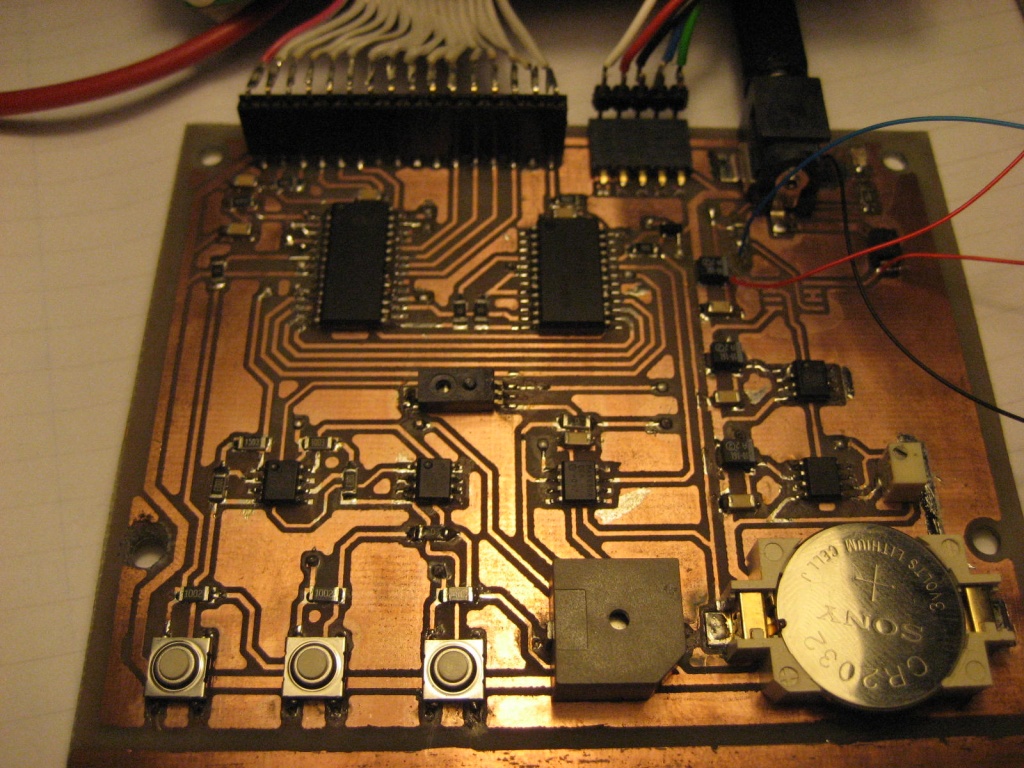

I managed to get it working although not sure how long it will remain reliable. Just kept plugging / unplugging it and then Pickit2 programmer made connection but said there was no operating system. Started to download operating system but it hung. Disconnected / reconnected and voila! Not sure it even actually downloaded the operating system. Oh well. Now I can at least plug it into the pcb I made yesterday, the first one I've done with mainly smd components. Unfortunately that doesn't seem to be working properley either! It's just one thing after another. Think I should take up knitting instead.
When you have programmer problems test the programmer using a know good target board. Once you have verified that the programmer works try it with the new/suspect target. Most of the time you will find that the target is the problem.
