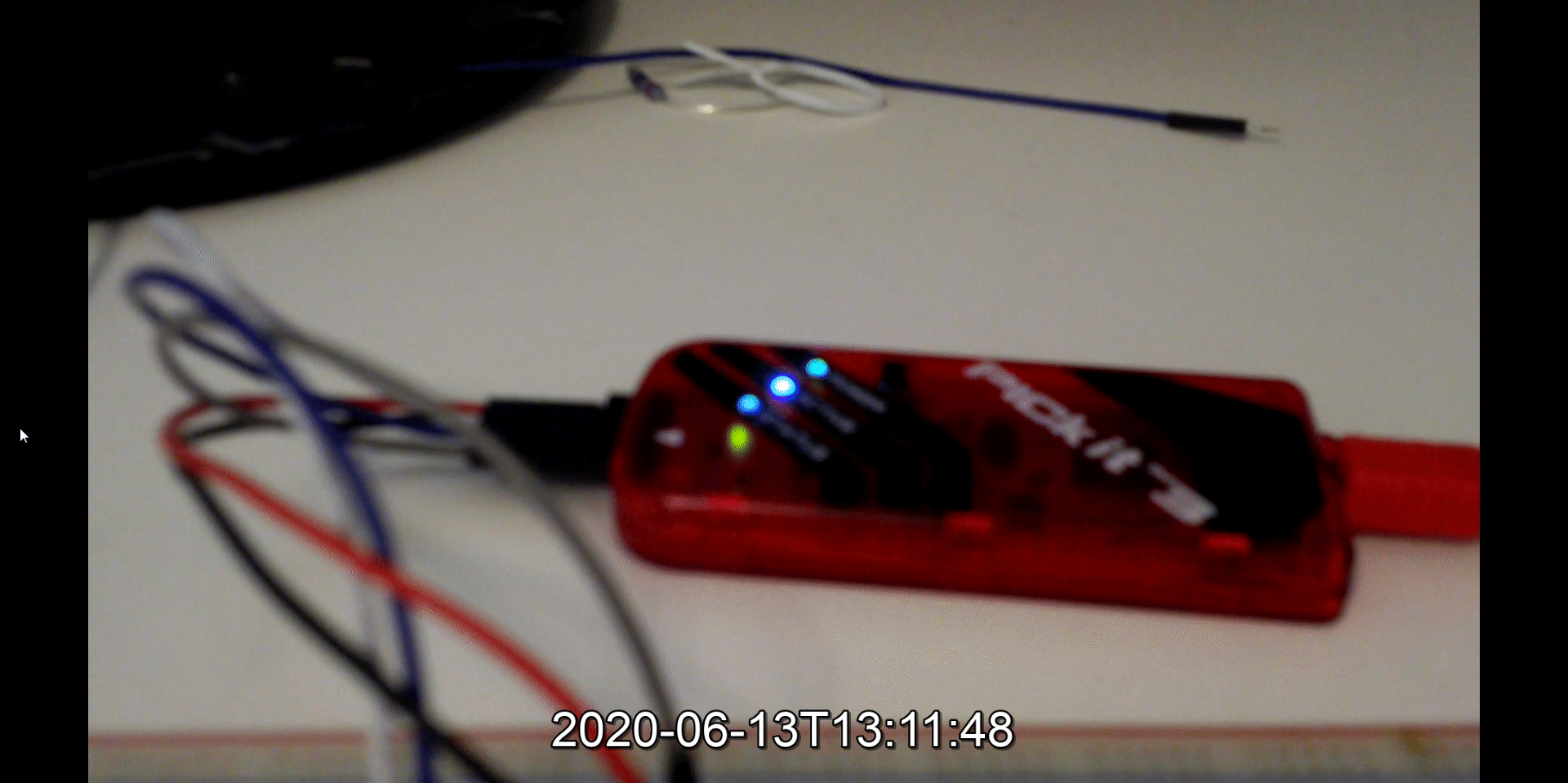

Hello everyone,
I'm brand new to micro-controllers and started with PIC16F876A and a Pickit3 programmer.
I wired it up and fired up MPLAB x IDE V5.4 and after a couple of days of reading and watching youtube I configured it to be powered up via the USB port with 4.5VDC.
I was able to download a basic program with no errors but can not get a red LED connected to RB4 to illuminate and while troubleshooting I couldn't figure out if a flashing red LED is normal.
It is right beside the Status LED and flashing at a steady rate which I think is every second. (Note: it appears to flash slower in the posted gif than real life)
Any ideas?

Just powered up my PicKit 3 and the power and active lights are lit and the status isn't. According to the manual page 39 the error (assuming continuous flashing) is that the PicKit isn't able to set Vdd or Vpp (more likely) to the correct voltage. Check your wiring.
In my experience it's usually Vdd that gives problems, as the PK3 can only supply a small amount of current - a big advantage of the PK4 is that can supply considerably more. Depending what's connected to the PIC it may not work when powered from the PK3, even an Hitachi type LCD is often enough to stop it working. 'Usually' you don't have anything connected to the MCLR pin, other than a 10K resistor to Vdd.

I don't see it. I checked the wiring and removed the LED I had connected and the result is the same. To add more information, below is the output after I connect the USB and MPLAB-X detects and powers the kit.
When I first connect the kit and the output is finished I get LED light up as in picture, Power=Green-Active=Blue-Status=Green. If I click on the "Refresh Debug Tool Status" I get the same result, everything looking good; no flashing red.
Then I click on "Make and Program Device Main Project" and at the bottom of the output window I get Programming/Verify complete, and that's when the LED starts flashing.
I will post a link to a youtube video to show the difference between the status LED being red when programming the chip vs after. The flash after seems to be smaller and to the side of the Status LED.
Here's the link to the video.
I've never been able to successfully power any chip with the PicKit3. I always use a separate power supply to power it. Are you able to power it this way?
Edit, as it successfully programs it then I suspect it's Vdd that isn't high enough - if it was Vpp then it wouldn't program.
Edit, just looked at your image and there's no crystal or capacitors that are needed with the 876.
