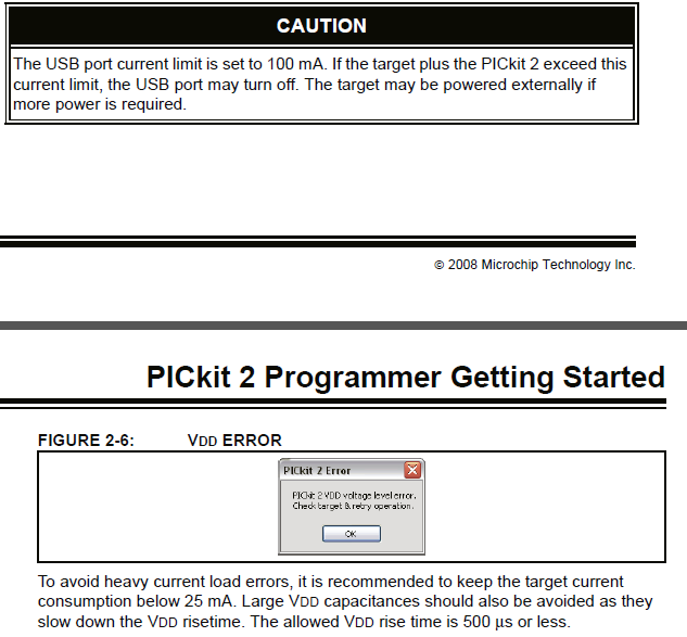

Not quite. The 100mA spec refers to the USB port. This is from pages 18/19 of Microchip's PICKit2 User's Guide:
Although, Microchip may have overengineered the PICKit2? I always have the PICKit2 supply power to my device under test...never a problem.
