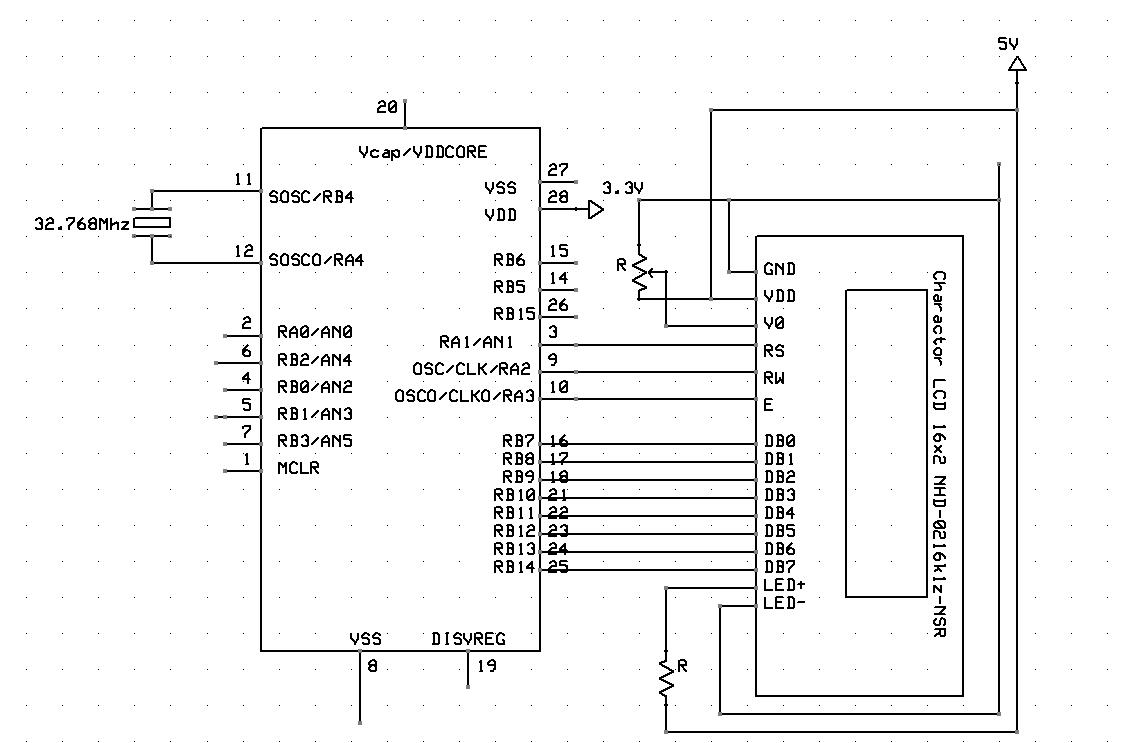

So I am working on my first project and was trying to get my schematic down before i started learning to code. I bought the "learning to fly PIC24" book. I have a few beginners questions;
1. My project will include a 4x4 keypad and a 16x2 LCD screen with the PIC24FJ64GA002 controller, can i hook all of this up to a 28 pin PIC24?
2. I plan to use the basic 16x2 LCD hd44780, but i have no idea how to lay it out on my schematic, which pins go to which D0-D7, do i want 8 bit or 4 bit? I can find examples every where for a PIC16F/PIC18F but no PIC24. Just what to plug in where?
3. Also is there a standard way of hooking up the hardware to make coding the LCD/KEYPAD easier?
Thanks in advance for any help and if my question are amateur sorry again its my first project!

The 4x4 keypad will require 8 pins and the LCD can be run from as few as 6 pins in write only 4-bit mode.
The program that you write to the PIC to run the LCD will dictate which pins go to where. The examples for the 16 and 18 families will be helpful for you to learn the theory of operation. The 24 family is 16 bit while the 16 and 18 families are only 8 bit but the basic theory of micro controller operation and driving an LCD will not be much different.

The 24FJ is a 3.3v part. Your LCD is probably a 5v device. The 24FJ does have 5v-tolerant pins, but you will need external pullup resistors. You will need to be careful which pins you use since not all have 5v tolerance. You will need both 5v and 3.3v regulators. You need a low-ESR cap on VddCore. You will need to power the board on an ICD2 since the ICD2 cannot supply 3.3v power.
If it's C code, in general it'll work on the 24F just like the 18F. There will be some differences, the config bits will all have to change, you need to config the oscillator, you need to set the ADPCFG bits, you need to configure the 5v tolerant pins as open-drain.
The 24F is supported just fine with Microchip's MCC compiler.
The 24F is a lot of chip for this project. Due to it not being 5v, and its cost, I wouldn't choose it from the beginning. If you already have it, well, it's a fine chip. If you want to do more stuff later, it's a pretty powerful little toy.

The HD44780 is a common LCD driver IC. When the PIC "talks" to the LCD it will be sending data to the HD44780. The HD44780 IC will in turn take the data from the PIC and change the LCD display accordingly. The data must be sent according to a specific protocol in order for the HD44780 to understand it. The program you write on the PIC should make sure that the data is properly formatted.
There are several ways you can write a program to send the properly formatted data. Your can have your program manually format the data or you can use a pre-written library that formats the data for you.
In the first case, it doesn't matter which pins on the PIC you connect to which pins on the LCD as long as your program is written for the specific way you decided to connect everything.
For the second case, the pins you use to connect the PIC with the LCD depend on the specifics of the library you are using. Some libraries require you to use only certain output pins while other libraries allow you to specify which pins you will use in the function prototype. I don't know anything about the library your book uses (if it is in fact using a library) so in that case I would just follow the example.
We might be able to help you more if you supply a schematic and your code.

This part features a Peripheral Pin Select Crossbar, which is a godsend to board designers because most peripherals- both input and output- can be assigned to the pins which work out best on the board. I can do some REALLY complicated stuff with a single-sided board with PPS and the wires won't need jumpers. Pins labeled "RPn" are remappable.
However, the Parallel Master Port- PMP- is NOT a remappable peripheral. It's permanently tied to the pins labeled "PMxxx". If your demo board does not wire the LCD to these pins, you cannot use the PMP. However, if they ARE wired to the PMP pins, the PMP can still be turned off and the LCD controlled through the pins used as regular port pins.
You don't need the PMP to talk to an LCD. In fact IMHO it'll unnecessarily complicate the project. And it won't teach you much, frankly, the PMP is a very specific module so it's not gonna teach you much about how IO works. Unless you SPECIFICALLY want to learn to use the PMP, just write to the port pins like 99.9% of people using PICs and LCDs. Code written for the PMP would need some significant rewrite to use the port pins- then again, there's like a million pieces of C code out there for controlling LCDs with PIC through the normal port pins.
The use of the PMP requires a part with a PMP, like the 24FJ64ga002. A limited subset of the PIC product lines have a PMP, and the way the PMP module works may vary. Ports, however, ANY PIC with enough pins can do that, and the way the ports work does not vary, C tasks written for the 16F will generally work on an 18F, 30F, 24F, and 33F.
What's the difference? Well, I can write all of 16 Port B's output pins to 1 (high) at once as "LATB=0xffff;" PIC 18F uses 8 bit ports at most.
The PMP allows you to configure the PMP module and write to a FIFO buffer to send the words out. But for an LCD, the writes are so simple it's way more complicated (and risky, the modules sometimes have "gotcha" problems where it won't work the way you wanted, or even errata bugs) than just writing the port directly.
I recommend you configure the LCD for 8-bit writes. You will need to be sure that you wire all the LCD data bus pins to a single port, in order. D0=RB0, D1=RB1, ... Or D0=RC0, D1=RC1, ...

I am able to find lots of example code on how to do the 18f in 4bit mode with the hd44780 controller. However i am having problem findinding example code for the 8bit mode. But you think the 8 bit mode would be easiest for codeing, and manipulating on the pic24f?
BTW this is a basic schematic i put together for the LCD portion of my project. I may just give up and use an 18F since their are full blown code examples that work and the stupid book only taut how to write the code in the PMP format which i wrote and compiled successfully but have not ordered a chip or lcd yet so cannot test it this code is soooo different from all teh example code on line its hard to compare. Also below is the code i wrote with the help from the book that is suppose to work i guess, if the pic24 has the PM pins which i dont think the PIC24FJ64GA002 has.
