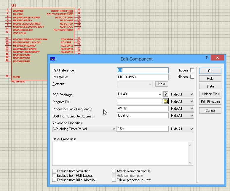

I want PIC18F4550 CPU to run at 48 MHz in Proteus. That it fails.
If you look at the screenshots (pictures) in the folder Proteus from my link above, you can see that I did specify the CPU frequency in that Edit box inside the Proteus and I mentioned it 48MHz.
I want 48 MHz for the CPU and that should be mentioned inside Proteus where is that Edit box, isn’t’ it?
Then why do I see 4 MHz in your screenshot?

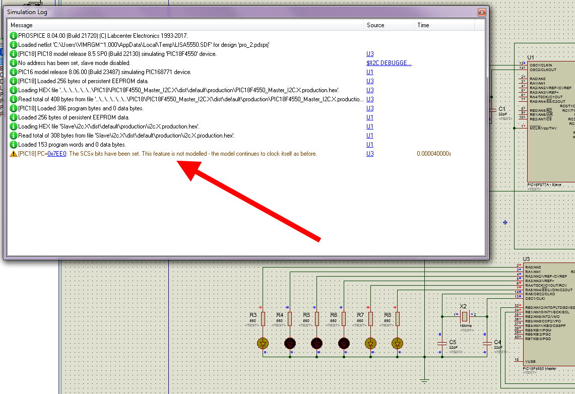

I’ve got the proof, the game ends here.
I have setup an I2C communication between PIC18F4550 as Master and PIC16F877A as Slave. All is done with MPLABX XC8 and then simulated in Proteus. And it works fine.
When the simulation starts, there is a message about PIC18F4550 saying:
[PIC18] PC=0x7EE0. The SCSx bits have been set. This feature is not modelled - the model continues to clock itself as before.
The SCSx bits are in OSCCON register, page 34 of the PIC18F4550 datasheet and set the system clock source:
bit 1-0 SCS1:SCS0: System Clock Select bits
1x = Internal oscillator
01 = Timer1 oscillator
00 = Primary oscillator
In other words, in Proteus, when you simulate PIC18F4550, you should use only internal oscillator, because the external oscillator is not modeled.
