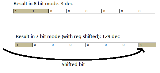

Thanks for the reply Ian Rogers. It is working with the instruction set you gave me, but the problem is that the last bit is being shifted to the first bit and i dont want that to happen when the last bit is 1. Is it possible to shift it and replace the last bit with 0 instaad of replacing it with the fist bit??
the reason why i want it to be like this is because if lets say in 8 bit mode, the value is 10000000, when shifted it will end up greater than the value in the 8 bit mode. (see attached pic)

In your attached picture you have the MSB and LSB mixed up but that's neither here nor there as long as you know which bit is what in the program...
0b11000000 = 192
0b10000001 = 129
is the conventional way.
0b11000000 = 192. rotate right...
0b01100000 = 96. rotate right...
0b00110000 = 48. rotate right...
0b00011000 = 24.
Everytime you shift the bits once to the right you halve the original number. If you are using 'RRNCF' then your carry bit (the LSB which gets shifted out) will not set your MSB. Perhaps paste your code so we can have a look. My assembly is a bit rusty but it still works ;)

Ok i found a way for this problem :) after the 'RRNCF REG1' command i wrote 'BCF REG1,7'. That way if the shifted bit is 1 it will be cleared. Tomorrow i will put this coding in the actual code and will let you know if it worked fine . Thanks very much for your help guys ;)
Ok i found a way for this problem :) after the 'RRNCF REG1' command i wrote 'BCF REG1,7'. That way if the shifted bit is 1 is will be cleared. Tomorrow i will put this coding in the actual code and will let you know if it worked fine . Thanks very much for your help guys ;)
Nice I was going to suggest masking it but that works just the same :)

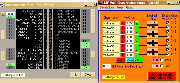

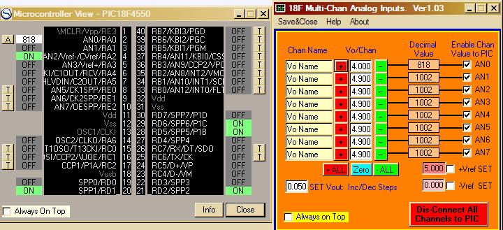

adrian,
This code now works.
I have preloaded REG with '64 decimal', this is equal to 4.0Vin to the adc, adc counts 818.
Used PORTA1,2 as outputs to show the compare result.
Also simplified the Header for testing.
