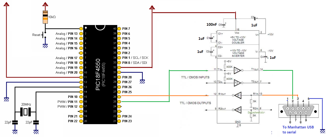

Do you have a diagram to post of the PIC/MAX232 to PC wiring.?
I edited the attached diagram to show how the connections were made:

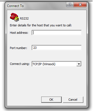

I am going to re-install the Hyper Terminal and it is asking for the following details. What shell I input please?
If I am reading your diagram correctly, you have the 9 way 'D' connector wired the wrong way around!
Pin 5 is Ground, pins 2 and 3 are Tx and RX
It should be as this image.
Sorry I did a mistake while editing the diagram. I re-uploaded the diagram.
Regarding post #51, what shell I input please?

Noted your corrected drawing..:)

I was reading on how to set hyper terminal and it looks like it only works with Windows XP. Is that true? because I am using Windows 7 (64bit). Can I use PuTTY instead?
You need to set Hyper terminal to use a direct COM connection... When you plug your USB/RS232 cable, you should get a enumerated port number... ie.. COM7 or something..
Yes!! You can use putty... But the same applies.... Once you configure the virtual com, you can use any terminal software...
