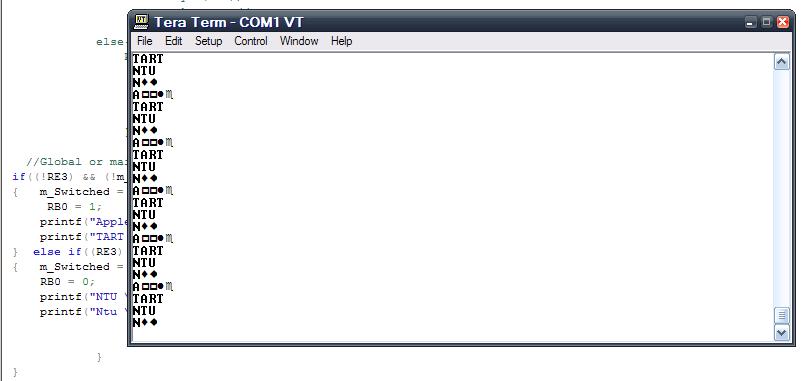

found out something weird.
my current code is
if((!RE3) && (!m_Switched))
     {	m_Switched = true;
	 RB0 = 1;
	printf("/// \r\n");
     }  else if((RE3) && (m_Switched))
     {	m_Switched = false;
	RB0 = 0;
	printf("Ntu \r\n");     }
, why does the output turn out to be as the one shown in the attached file..
Does the above codes only allow capital letters to be shown or?
*problem solved. i restarted the TeraTerm and i have a proper output combi of capital & small letters now*
It looks as though you are getting some corrupted data somewhere.
The link you provided looks like a toggle momentary switch.
The code doesn't affect the output, it should output as you typed.
Try adding a "\0" to the end of the strings to terminate them.
