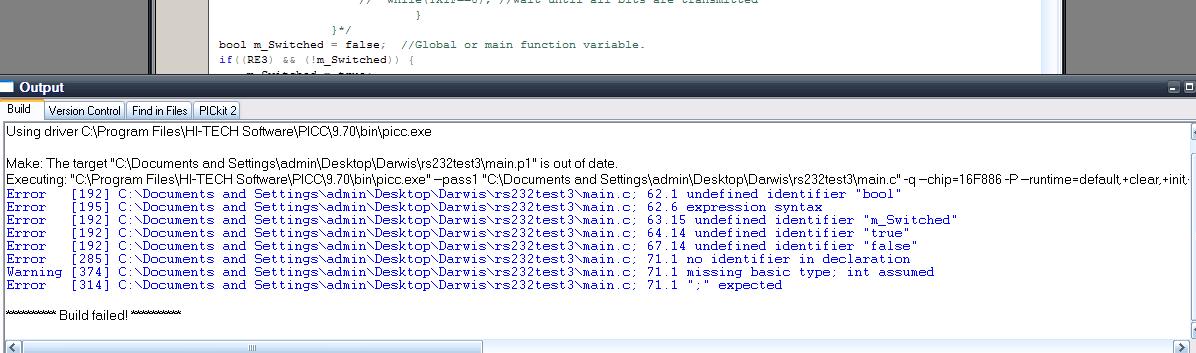

guess it cant be understood by MpLab? as i am unable to use ur codes above...
\trying to see if there's any simliar way
Hmm, the formatting messed up for some reason, I just edited and saved the post, see if you can copy + paste that, seems to have fixed it.
Wilksey
Hmm, the following showed up when i editter the code.
Think its the same errors shown
Hmm, i just tried it out again and it can be compiled this time round. However, nothing was produced. the led doesnt light up anymore too when i pressed the switch.
Ugh! Sorry I forgot you were using hitech c for some reason!
Try this:
void init_rs232();
#define true 1
#define false 0
	static bit m_Switched = false;  //Global or main function variable.
	if((RE3) && (!m_Switched))
		m_Switched = true;
		printf("Apple\r\n");
	else if(!RE3)
		m_Switched = false;
Note: the #defines go AFTER the function prototype, but BEFORE the main function.
Give that a try.

as RE3 switch is 0 when it is pressed, i changed ur codes to the following (only a change in the !RE3 and RE3)
if((!RE3)  && (!m_Switched))  {
	m_Switched = true;
	printf("Apple \r\n");
}  else if(RE3)  {
	m_Switched = false;  }
when i tried this out, nothing came out when i didnt press the switch (which is somewhat what i eventually desire), but it still gave me continous Apple on consecutive new lines when i pressed the switch. Hmmm~

void init_rs232();
#define true 1
#define false 0
void main()
	OSCCON = 0x75;
	TRISA0 = 1;
	TRISB = 0x00;
	init_rs232();
		while(1)
			if (RA0) //&& (!m_Switched))
				m_Switched = true;
				RB0 = 1;
			else if(!RA0)
				m_Switched = false;
Wilksey
Yes, it should transmit "Apple" until the switch is depressed / off
It acts as a second trigger, a software switch if you will, once it is triggered it will remain set until the switch is 0 then it will reset itself.
