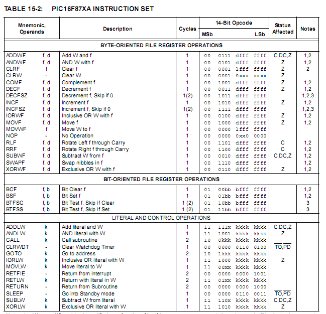

The PIC divides the crystal/clock freq by 4.
So a 4MHz xtal would give a cycle time of 1µSec
and a 20mHz / 4 = 5MHz == 200 nanoSec.
OK.?:)
EDIT: most Instructions take 1 cycle time, about 4 or so take 2 cycles.
This clip shows the cycles.

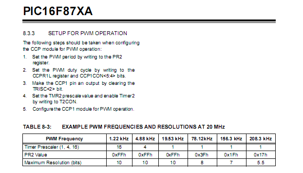

Another thing I found that I should have included in my other questions is
Nigel's talking about the PR2 register on here where does he get the number to store in there from? Also T2CON sets the frequency of the PWM I get that part but then he goes on to say 20MHz is to high a frequency....I think I might have just figured it out that part of it out while I was typing it but I'm going to put it here and ya'll tell me if I'm doing it right. T2CON sets the period for the PWM you need to set the pre scaler to divide by so much to match 50MHz? Hmm well I thought I had it figured out but as I type it it's not making sense anymore.

The PR2 prescaler is a 8 bit divider ie: 0 thru 255 ,, 127 is the centre value, chosen to give fwd and rev operation.
The figures in the datasheet are for 20MHz, thats why Nigels says they have to be adjusted to suit the xtal frequency in use.
Look at this extract from the datasheet.
