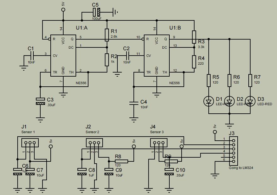

I have two PCBs. PCB1 contains PIC, Comparator and hbridge. PCB2 contains the IR LEDs and IR receiver modules. The first sensor is located at front, 2nd at left side of the mobile car and 3rd at the right side. I would like first to try it on flashing LEDs on the PIC before giving it a try on the motors. When an obstacle is detected in front, the 2nd LED will light. If an obstacle is detected on left, the 1st LED will light. If an obstacle is detected on right, the 3rd LED will light. I am having problems in using in the sensor part. The 1st sensor doesn't make the 2nd LED light even if I place an obstacle. Left sensor and right sensor works very well without any problems. The 3 IR receiver modules are different from each other that's why the schematic for each IR receiver module is different.
When I try PCB2 disconnecting from PCB1 and try PCB2 on a breadboard with only LM324 and variable resistor. The output of LM324 is connected to a visible LED to show that there is an obstacle detected. On if there's no obstacle and Off if there's an obstacle. The sensors are not having any problems at all. The 3 sensors function well. Is it possible to have problems with my program code?

Running your program in Oshonsoft shows that all 3 PORTB pins 4, 5,6 are normally high, as each one is set low a pin on PORTC goes high.
RC2 for B.6,,, RC0 for B.5 and RC1 for B.4
Thank you fro the reply ericgibbs. So there's no problem with my software? Its all about hardware?
Do you think its about power problems? What if I'll change the power source of the Sensor's PCB? Will it help?
hi
I have not looked over the circuit diagram, how are you powering the project.??
I'm using 1 9v for the PCB and 4 1.5v for the motors.
Have you tried to measure the outputs of the LM324 directly to see if they are changing.?
This would eliminate any possibility that the program is at fault.
If you dont have a voltmeter, use a led and a 1k series resistor has high/low indicator,,OK.?
