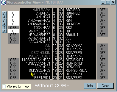

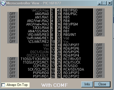

Hi all , i want to build a LCD thermometer with this two components but it seems i have a problem. When LM35 it's not connected to RA1 (analog imput) the temperature-voltage dependence it's correctly indicated (270mv-27C, 280mv-28C,,etc), but when i connect the output of LM35 to analog imput of PIC16f877a the output voltage of LM35 it's remain the same (145mv) all the time and there are not changes of voltage with temperature anymore. The power supply =5V.I don't know what is the problem.
The ASM code that i've writed (at the end of the convertion, the 8 bit are transfereted to the PORTB in order to see changes), and it is working perfectly with a potentiometer (10K) connected to Vss, Vdd and RA1:

Most common problem is that you have set the PORTA.1 to a digital output pin.:)
hi kta,
Get rid of that comf TRISA and the RA1 is unchanged from analog to digital.

The problem is still with the comf TRISA, its changing the PORTA pins back from analog as set in your ADCON, to digital OUTPUTS!.
