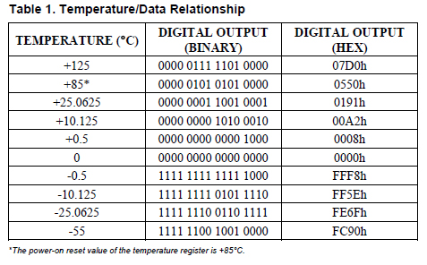

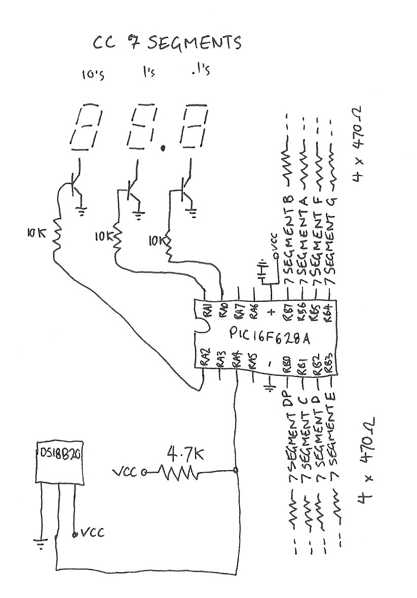

Well, This is my objective:
It is a temperature sensor project with the direct to digital DS18B20.
I am getting a 12-bit result out of the sensor.
With incrments/resolution of 0.0625 degrees C.
See attachment for temperature/data relationship.
So I have a 11 bit number (MSB is a sign bit 0 = positive 1 = negative) that i wish to display on a multiplexed 7 segment display. 2 digits + 1 decimal.

Firstly you work out what range you want: 00 degrees C to 99 degreesC.
Each degree is 1 0000 in binary.
Shift the 12 bit number 4 times right to get each degree in binary. Remome the highest bit.
Convert the number to BCD and output to the two displays via a single 0 to 9 table
Ok, thats half solved.
What about the decimal place
This is for the decimal place:
DECIMAL  HEXADECIMAL  TEMPERATURE-EQUIV  NUMBER-TO-DISPLAY
   0        0000           0                  0
   1        0001           0.0625             0.1
   2        0010           0.1250             0.1
   3        0011           0.1875             0.2
   4        0100           0.2500             0.3
   5        0101           0.3125             0.3
   6        0110           0.3750             0.4
   7        0111           0.4375             0.4
   8        1000           0.5000             0.5
   9        1001           0.5625             0.6
  10        1010           0.6250             0.6
  11        1011           0.6875             0.7
  12        1100           0.7500             0.8
  13        1101           0.8125             0.8
  14        1110           0.8750             0.9
  15        1111           0.9375             0.9
You said you had 2 digits. Why do you want a decimal place for temperatures from zero degress to 9 degrees?
