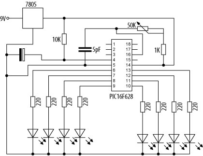

I have few numbers of PIC16F628 (not 16F628A) microcontrollers. I wrote a .asm code to test PICs like below.

The code can compile and program PIC without any error. But with practical circuit any LED not light up. Please anyone can tell me what is the error of this code?

Thank you for your reply. But I tried both ways. Last time I used a PCB with external RC oscillator. I send you schematic.
Kalinga.

The ER oscillator only uses a resistor and not a capacitor, however, 5pf is not going to make much difference. What I did notice was the lack of capacitors on the 7805. I can't see any reason the above code won't work so check your circuit carefully.
