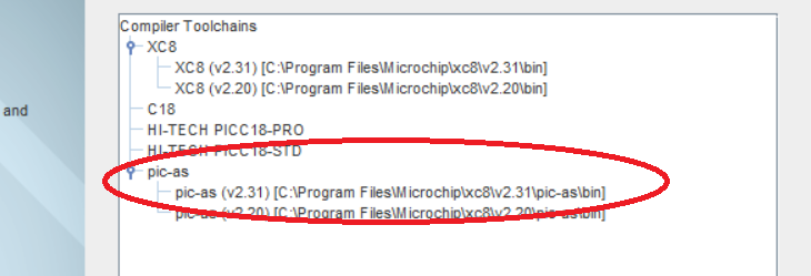

I am learning PIC microcontrollers from tutorials on CircuitBread for PIC10F200. Recently I wanted to simulate design in MPLAB X IDE 5.50 from this example: https://www.circuitbread.com/tutorials/pwm-led-dimming-part-7-microcontroller-basics-pic10f200 (at the bottom of the page are design files to download: XC8-PIC-Assembler-Creating-a-PWM-in-Assembly-Part-7-Microcontroller-Basics-PIC10F200.zip). In those tutorials variables are defined using EQU, but in MPLAB 5.50 EQU does not provide ability to view variables during debug mode. That is why I have changed EQU to DS. That is a declaration from tutorial:
That is my declaration:
Unfortunately i got those errors:

I am using pic-as 2.32. I attached main files: main.txt - from my project and main_tutorial - from tutorial project. I have changed the extensions from .s to .txt to be able to attach the files. How can I deal with those errors? Thanks in advance.
