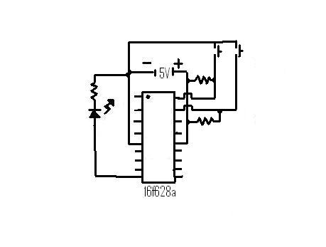

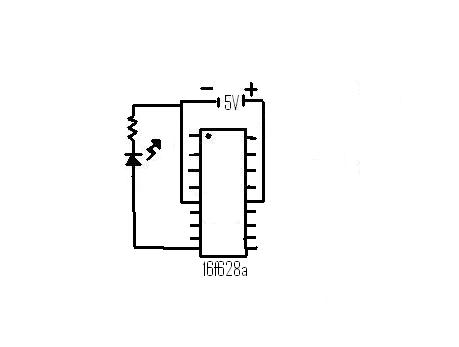

Here's a code that you can put a led with a resistor on any of the PORTB bits. I put it on bit3 like you are already using. In the code there is a place that says
movlw 0x44
movwf runn
If you change this value the time it takes to fade changes. As is it fades out a few times a second. Something I noticed when writing this code is that leds do not light up in a linear fashion. You have to have an exponential increase in the PWM to get an even fade. This code if really long for what it does, but I hope it's easy to follow and does what you want. I also put a circuit that shows how to put the led. The short leg/the flat side is the - side.
Hey, thanks for the code. It does work. It dosn't seem to fade down as far as I want to go, but i'll play with it.

Andy the code to fade the lights doesn't fade the PWM all the way down to zero but that would be easy to fix. Change the "duty cycle values" The closer to zero the darker it gets. Remember when you change them that the leds light up in an exponential fashion.
The header of the code I used was taken from another code. When I got errors from MPLAB I changed them until they stopped showing errors. (pretty scientific huh) I'm still learning about how to write code properly. Actually I wanted the internal oscillator turned on but I don't understand the data sheet so well. I tried to fix the header. Hopefully someone who knows will double check it. Really I don't know the secret to get the code from one pic to the other is. What I did was steal a header from a code that I know works and then I copied it into my code. In the rest of the code and circuit I use the datasheet to make sure the ports and bits are all assigned properly and wired correctly.
Here is a new code with two switches. They change the speed of the fade when you turn them on (close the switch). Also I put a revised circuit. I hope this helps.

start
	movlw	0x44			;adjustment for speed of fade
	movwf	runn
	btfss	PORTA,0			;call to see if low, if low make fade slower
	call	slower
	btfss	PORTA,1			;call to see if low, if low make fade faster
	call	faster
