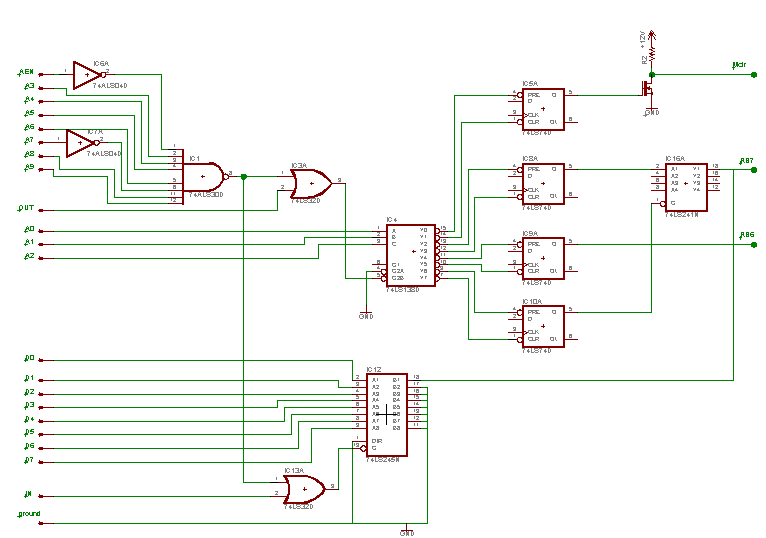

I've updated my ISA bus Pic programmer schematic..
thanks, to all who helped me get this Eagle layout software, working...
i still have to tie up some loose ends on this schematic , but this is basically it..
notice i've labeled it PC control..thats what you can do with it..
My latest use is to read a microchip MCP3004 Serial A/D converter with it..
i just simulated the signals of the SPI interface.
the signal labled RB6 i used for the clock.
Din & Dout connect signal labeld RB7
and i connected the signal labeld MCLR to the chip select line.
The only adjustment i had to make was to drop the voltage on MCLR to 5 V .
Like i said earlier i still have to check the schematic against the board.
I left the B inputs to the LS245 open , depending on how many data sources you want to use.Right now i have all but D0 grounded (so the data From the 3004 comes in as either a one or a zero.
also the DIR on the LS 245 isnt connected in the schematic that should go from B to A.
luv this Layout program!!
