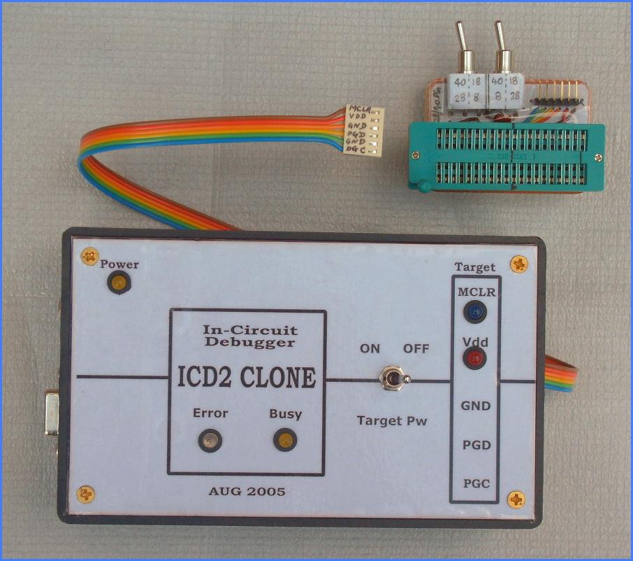

bryan1 said:
So if I was to transfer the target PGC, PGD, Gnd and MLCR lines straight to the ziff socket would this be a problem? Sorry if this is silly question but I want to be sure.
Cheers Bryan :D
No problem if you know exactly which pin(s) they should go to. But do you? Don't forget the PGM line too.

Hiya Eblc1388,
I wonder why the PGM line isn't on the ICD clone, also if you don't mind could you tell me where each line should go as I'm not too sure.
Cheers Bryan :D
bryan1 said:
Hiya Guy's,
I'm currently designing the ICD clone on veroboard and I was wondering aswell as putting in the ISCP header also putting in a 40 pin ziff socket configured to program from 8 to 40 pin pics. So if I was to transfer the target PGC, PGD, Gnd and MLCR lines straight to the ziff socket would this be a problem? Sorry if this is silly question but I want to be sure.
Consult the P16PRO40 circuit to see how it's done there!, the problem is how to NOT apply power to the wrong pins on larger chips - the P16PRO40 does this by using two seperate Vpp lines!. I don't think you can do it with a single Vpp line?.
Hi bryan1,
Nigel's message is what I'm trying to tell you. You can't have a fixed connection.
The PGM line is just 0V. i.e. you connect 0V to the PGM pin of the target PIC.
I solved the problem using switches.(see image)
